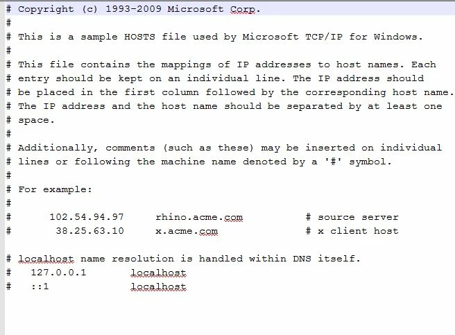

    Is your hosts file (C:\Windows\System32\drivers\etc) looks like this?
    You need to add 127.0.01 for localhost in the hosts file.
