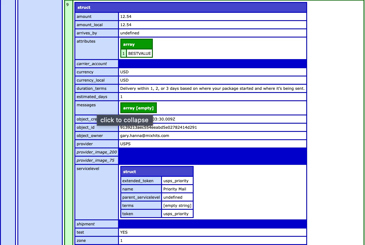

I have a stuct that looks like this:
If I need to display the attributes array. This works:
<cfoutput>#shipment_response.data.rates["9"].attributes[1]#</cfoutput>
 However sometimes the Array is [empty]. How can I determine if it exists? I tried:
<cfif StructKeyExists(shipment_response.data.rates["9"], "attributes[1]")>
</cfif>
It doesn't execute the cfoutput either way (exists or empty). What am I doing wrong with StructKeyExists?
Thanks in advance for any suggestions!
Gary

    Hi @ghanna1 ,
    What a delightful coincidence. I worked in shipping logistics for 6 years, and processing XML data similar to yours was the daily grind. 🙂
    Your current approach is on the right track. A response may or may not have attributes. When it does, then the attributes array is either empty or non-empty.
    With that in mind, you could extend your approach as follows:
    <!--- Does 'rates["9"]' have an 'attributes' key? True or False --->
    <cfset attributesArrayExists = structKeyExists(shipment_response.data.rates["9"], "attributes")>
    <cfif attributesArrayExists>
        <!--- Is 'attributes' array non-empty? True or False --->
        <cfset attributesArrayIsNonEmpty = arrayLen(shipment_response.data.rates["9"].attributes) gt 0>
        <cfif attributesArrayIsNonEmpty>
            <!--- Do your stuff here --->
        </cfif>
    </cfif>
    Or, in short:
    <cfif structKeyExists(shipment_response.data.rates["9"], "attributes") and
    <cfelse>
        <!--- Handle exception here: "attributes" doesn't exist or is an empty array --->
    </cfif>

    Gary, use the little-known arrayisdefined, introduced in cf8.
    Or there can be times when this sort of problem might be solved as well using either the elvis operator or the safe navigation operator.
    Let us know if any works for you.
    /Charlie (troubleshooter, carehart. org)
    ghanna1Author
    Feb 22, 2022 1:22 AM UTC
    Thanks Charlie. ArrayIsDefined works perfect!
