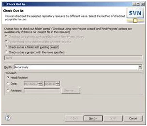

  • I delete the index.cfm” file and right click on the “test1” folder and select “import”, then select SVN > Project from SVN. I then select my repository location and select finish, which opens the SubVersive “Check Out As” popup as follows with “Check out as folder into existing project” selected:
  • I then select the “test1” folder within the project as the destination for the check-out and select finish and the code checks out as expected.
  • My first problem with this approach is, the “test1” folder now contains a sub-folder (because the only option was to "check out as folder") of the checked out project, but let’s ignore that problem for now as wehave bigger fish to fry.

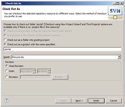

  • While I have no opened projects, I select “File > Import > SVN > Project from SVN” and select my repo and select Finish, again this will open the SubVersive plugin popup with “Check out as a project with the name specified” selected:
  • I leave the project location to its default location, which is “C:\Dev_Tools\CFBuilderProjects” and select Finish and the code checks-out and the project is created as expected.
  • As you can see here, the project has checked out but it’s not a ColdFusion project (it doesn’t contain the CF icon as the project above did):

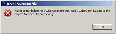

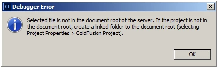

  • To confirm this, if you select index.cfm and select Run, you get the following error:
  • So, now I right click the project and select “Apply CF Nature”, which makes it a CF project, as you can see here:
  • So, now selecting the file “index.cfm” and select Run, I get the following error:
  • So I now configure the project to work with this project (by right click the project and select the correct server under the section “ColdFusion Server Settings”) and try to run the index.cfm file again and get the following error:

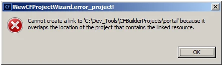

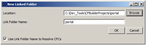

  • So I now try configuring the mappings for the project as instructed by adding the path where the source code exists to a folder names “portal” like so:
  • But I get an error when I try to add this:

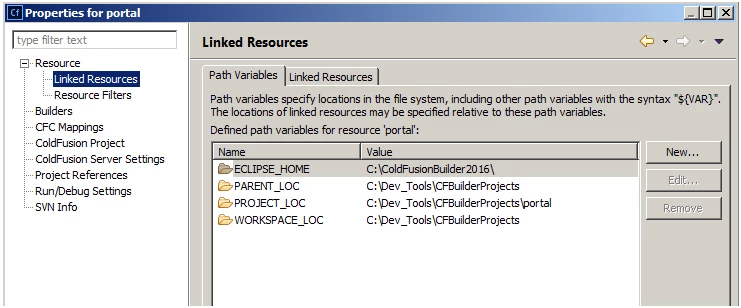

  • Which is true, I can see this looking at the linked resources:
  • At this point, I give up.... well, I actually tried a few other things like configuring the servers root etc... but had no joy.
