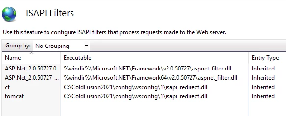

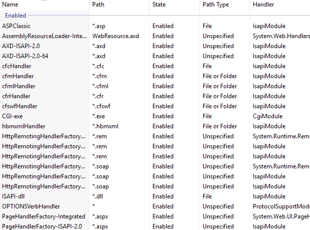

    When you say, you added the ISAPI filters, could you be more specific, if it was done manually or if you used the wsconfig utility?
    Also, send the screenshot of
    1.  handler mapping for Site
    2. Isapi filters for Site
    3. ISAPI and CGI restrictions at root level.
    Thanks, Priyank Shrivastava
    taunntAuthor
    Nov 2, 2022 3:01 PM UTC
    1.
    2.
    3.

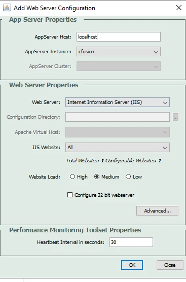

    4. WSCT
     You can see for 2 I added them and the the web server config tool did one too. If I delete one it doesn't make a difference. I can also see cfm files on the server if I use localhost. If I try it with the ip address it goes white, but only for cfm files.
