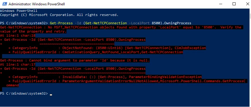

    Hi ​@DevScreen , At this stage, I would tend to believe the error message. Some other process is probably running on or using port 8500 even after ColdFusion has stopped. Did you stop the other ColdFusion-related processes such as Add-On, .NET and ODBC?
    To find which process is using port 8500:
    1. Stop ColdFusion and every ColdFusion-related service. .
    2. Open Windows Powershell, and run the command
      Get-Process -Id (Get-NetTCPConnection -LocalPort 8500).OwningProcess
    Charlie Arehart
    Jul 7, 2026 1:39 PM UTC
    BKBK, note that they'd said previously here that they'd already confirmed via netstat that it was indeed the coldfusion.exe process holding the port. That's why I offered what I did yesterday.

    BKBK
    Jul 7, 2026 10:22 PM UTC
    Hi Charlie, now noted.

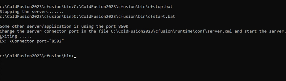

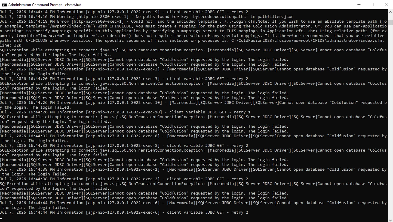

    DevScreen
    DevScreenAuthor
    Jul 7, 2026 10:02 PM UTC
    Hi Charlie and ​@BKBK , Thanks for your reply.  I am not directly involved, so I had the person who handles this give it a shot.  He tried a couple things based on your messages and attached are the screenshots.  I got an email alert that you had posted replies (which I forwarded to the person), but I just realized right now that the email did not have your Charlie’s entire post - it had truncated it.  I just sent him another email with full contents and we will give it a shot again tomorrow.
    “Decided to try running cfstart.bat file again to see if the output would be different now that all services are stopped, and it was different.  Lot of text about processes starting, but got stuck on this”

    ​@DevScreen , I would suggest that you
    1. begin by stopping ColdFusion using, for example, the command C:\ColdFusion2023\cfusion\bin\cfstop.bat
    2. then run the command C:\ColdFusion2023\cfusion\bin\cfstart.bat
    DevScreen
    DevScreenAuthor
    Jul 6, 2026 1:29 PM UTC
    Hi ​@BKBK
    We tried it and got the same message as before.

    Adobe Employee
    Jul 2, 2026 4:54 PM UTC
    Hello DevScreen,
    Can you please open command prompt as admin, start the instance through command prompt using cfstart.bat command and share the output
    ColdFusion2023/cfusion/bin>cfstart.bat
    Once starting access the admin and share the output of the command prompt
