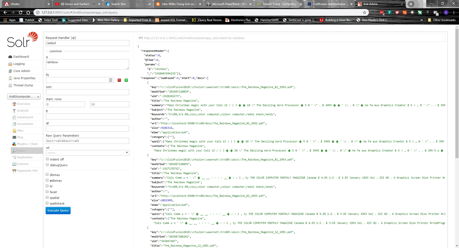

Like the hosting provider I ran the query directly in SOLR on my development machine. Unlike the hosting provider’s machine it returned an additional column in the search results called “contents” (ah ah).
This first image is the query run on dev.

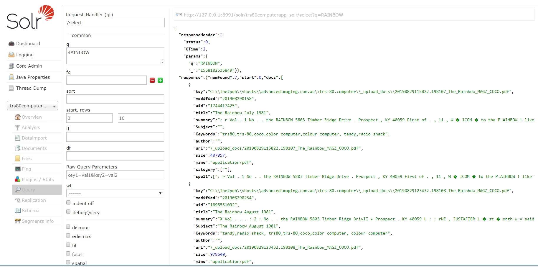

This next image is the query run on prod (note the absence of a "contents" column).
Despite its absence in search results on prod it does exist in teh schema but what I'm seeing is that the contents column on prod is not indexed, tokenized or stored whereas on dev it is. (reading the fourm post linked above will clarify this).

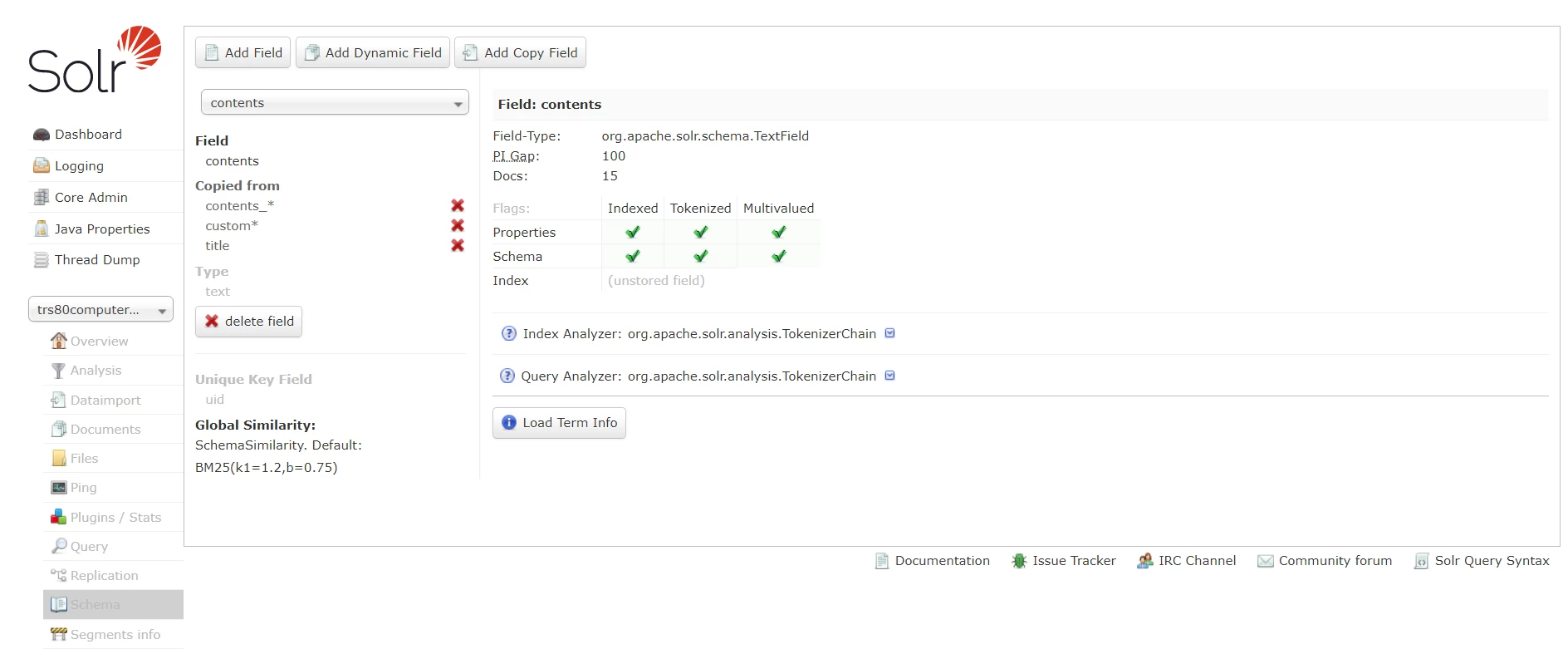

The next image is the config for "contents" on my dev machine.
And the next one is the config for "contents" on prod. Note teh difference in teh state of "Index".
I think it’s safe to assume that when CFSEARCH retrieves context its doing it from the stored "contents" - that makes sense and also explains why you can vary the number of context passages in a search. This also explains why the system (prod) was unresponsive to programmatic requests for a change in context length.
