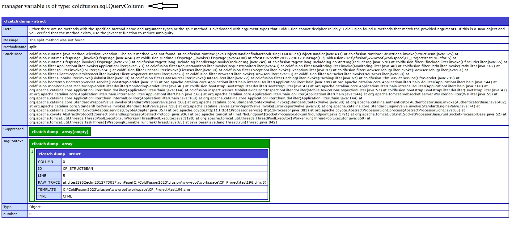

    Charlie, my last post contains your suggestion. It is clear from my last post that the issue is caused by the variable manager calling the split method.
    In fact, you can reproduce it yourself, using:
    <cfset Q_ADResults = queryNew("manager","varchar", {manager="CN=Maria Guadalupe López,OU=Human Resources,OU=Nogales,OU=Mexico,OU=North America,OU=Domain Users,OU=Offices,DC=humanscale,DC=com"})>
    <cfloop query="Q_ADResults">
    	<cftry>
    		<cfset mgr = manager.split(",")[1]/>
    	<cfcatch>
    		manager variable is of type:<cfoutput> #manager.getClass().getName()#</cfoutput> <br><br>
    	   <cfdump var="#cfcatch#" label="cfcatch dump">
    	</cfcatch>
    	</cftry>
    </cfloop>
    The result is
    The cause of the issue is that the method split() is being called by manager, which is not of String type. It is of type coldfusion.sql.QueryColumn.

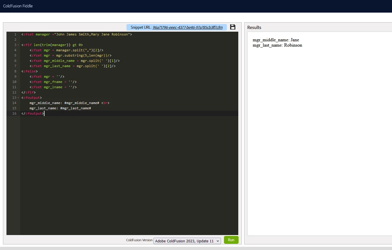

    Oct 27, 2024 9:49 AM UTC
    Like @aliaspooryorik , I too did a test on CFFiddle using Update 17 of ColdFusion 2021. There was no error.
    <cfset manager ="John James Smith,Mary Jane Robinson">
    <cfif len(trim(manager)) gt 0>
    	<cfset mgr = manager.split(",")[2]/>
    	<cfset mgr = mgr.substring(5,len(mgr))/>
    	<cfset mgr_middle_name = mgr.split(' ')[1]/>
    	<cfset mgr_last_name = mgr.split(' ')[2]/>
    <cfelse>
    	<cfset mgr = ''/>
    	<cfset mgr_fname = ''/>
    	<cfset mgr_lname = ''/>
    </cfif>
    <cfoutput>
    	mgr_middle_name: #mgr_middle_name# <br>
    	mgr_last_name: #mgr_last_name#
    </cfoutput>
    https://cffiddle.org/app/file?filepath=5149d2c1-49d1-4aca-879c-4e6ef33ff4c3/e3ecff66-71ce-4e00-bd2e-cdd58947ee0a/7afa49cd-80a9-463c-82f8-606910ffa8cd.cfm

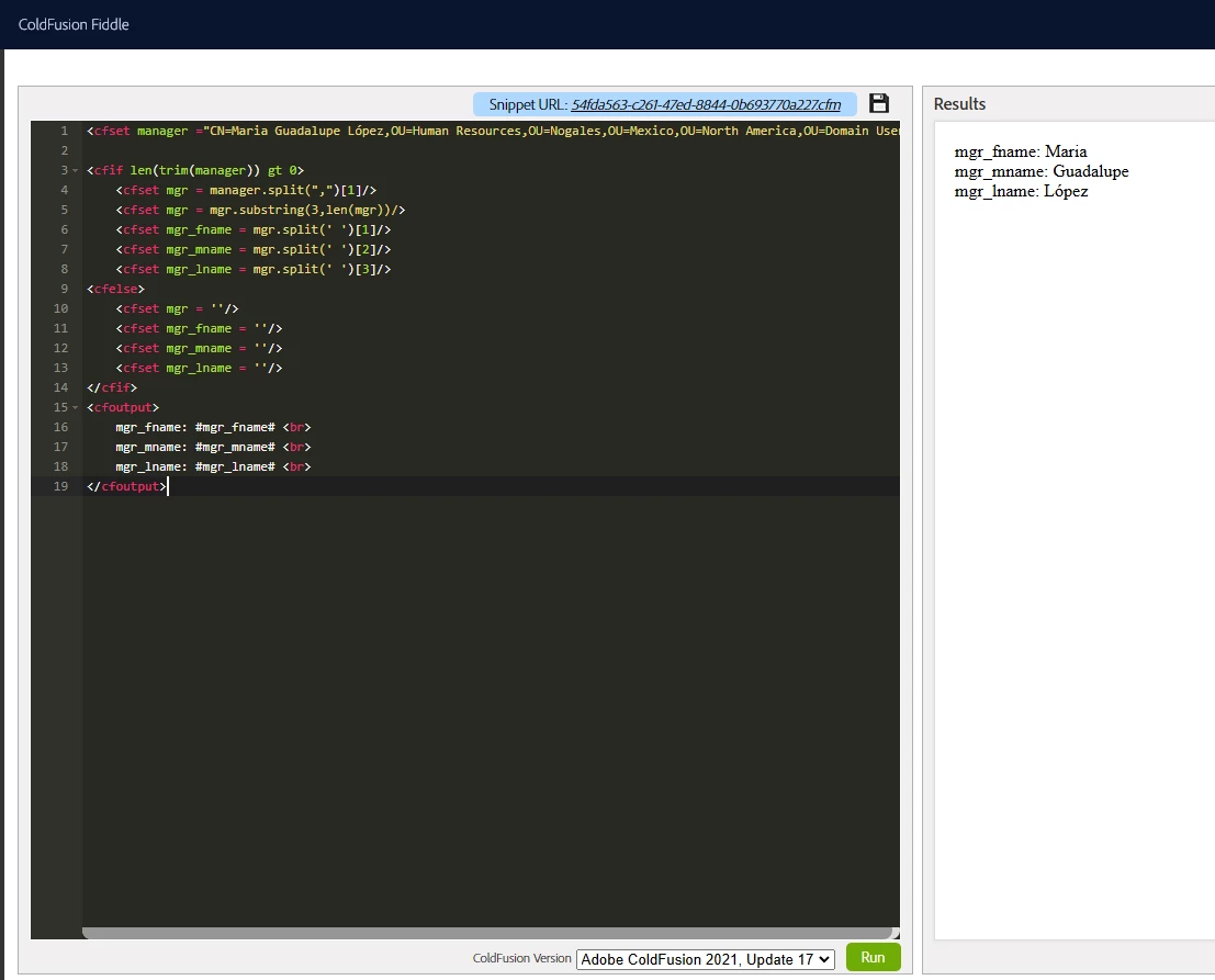

    Taking the hint from you, I ran the following code on CF2021 Update 17 on Cffiddle:
    <cfset manager ="CN=Maria Guadalupe López,OU=Human Resources,OU=Nogales,OU=Mexico,OU=North America,OU=Domain Users,OU=Offices,DC=humanscale,DC=com">
    	<cfset mgr = mgr.substring(3,len(mgr))/>
    	<cfset mgr_fname = mgr.split(' ')[1]/>
    	<cfset mgr_mname = mgr.split(' ')[2]/>
    	<cfset mgr_lname = mgr.split(' ')[3]/>
    <cfelse>
    	<cfset mgr = ''/>
    	<cfset mgr_mname = ''/>
    </cfif>
    <cfoutput>
    	mgr_fname: #mgr_fname# <br>
    	mgr_mname: #mgr_mname# <br>
    	mgr_lname: #mgr_lname# <br>
    </cfoutput>
    https://cffiddle.org/app/file?filepath=9cf84e08-8565-43b6-b710-d8a0472bb9ac/73ad24d8-be36-4aa6-8586-0b1d4bf91b0d/54fda563-c261-47ed-8844-0b693770a227.cfm
    As you can see, it works as expected.
