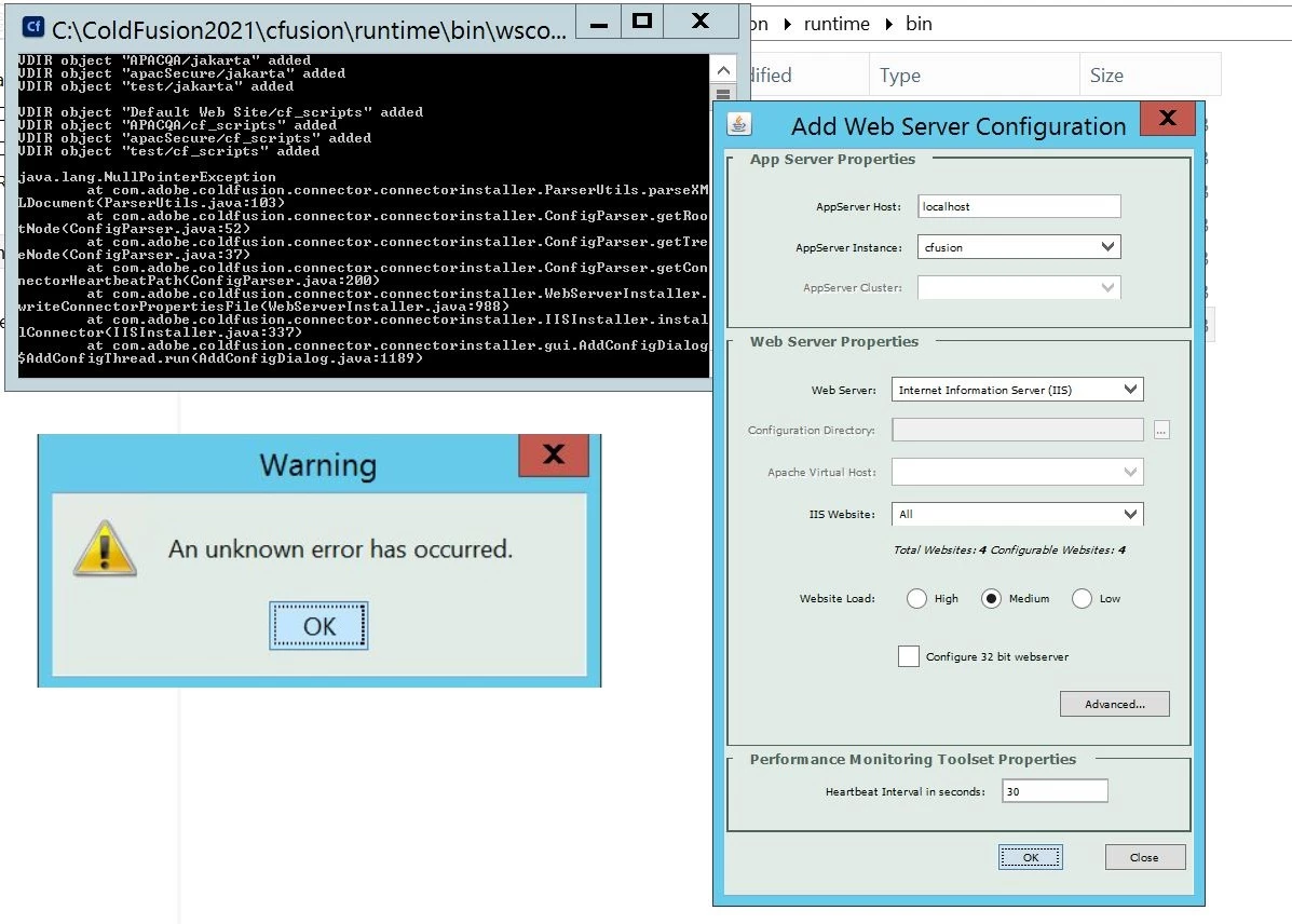

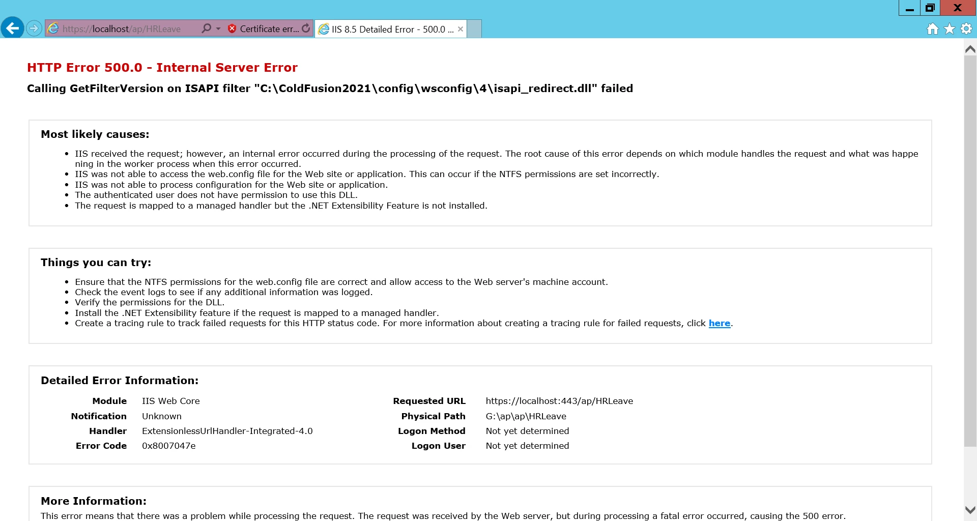

Hi, Team:
Good day!
We have ColdFunstion of 2016 version(ColdFusion_2016_WWEJ_win64) in one server before, now need to update to 2021 version, then I uninstalled the 2016 with its uninstall tool, then reinstalled the 2021 ColdFustion version(
ColdFusion_2021_GUI_WWEJ_win64), but after installed success,our current application system which developed with coldfusion cannot access, it prompt error, II try to install the web server with wsconfig tool for all IIS, but seems as error as below. Do you have some advice why install the latest version, current coldfusion system cannot work well? Is there anything other configuration?
By the way, do I need to 2021 API manager to replace the 2016 version API manager?
Appreciate to you if you have one member to help to resolve this issue, it is urgent. Thanks.

    Hi, Charlie:
    No, this is another issue which I want to upgrade from CF2016 to CF2021, I uninstalled the CF2016, but keep CF2016 API Manager, then install the CF2021, after installed OK, I view the IIS is build-in web server, so I want to use wsconfig.exe to configure for all IIS website, but it prompts error as above, but I'm not sure whether the wsconfig.jar file you provide can solove this issue or not, I will take one more try to use the new wsconfig.jar file you provide. By the way, I want ask, if I install the CF2021, do I need to uninstalled the CF2016 API manager application to install the CF2021 API manager or it still can be use with CF2021+CF2016 API manager? Thanks.

    Hi @damon wang ,
    I agree with Charlie: this is the same as the IIS issue you reported earlier.
    Did you apply the fix that Adobe Engineer, Piyush, gave in Tracker?
    The fix is: http://cfdownload.adobe.com/pub/adobe/coldfusion/PR/cf2021gm/connector_patch/wsconfig.jar
