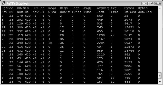

I am wondering if the results from CFSTAT can help me pin-point why my server sometimes bogs down?  What do the below stats tell me (click the image to see it full size)?  Is there a way to find out which page(s) started the backlog?

    The number of queued requests(Req Q'ed) aand timed out requests(Req TO'ed) are consistently low, mostly 0. So too is the average queue time(AvgQ Time). Whereas the number of database accesses per second(DB/Sec), the average request time(AvgReq Time) and the number of incoming bytes per second(Bytes In/Sec) remain consistently high.
    The low values imply it is likely your pages are running OK. The high values imply your pages are engaged in large, time-consuming processing jobs involving fetching data from the database.

    Michael, it looks to me like you’re just getting a burst of traffic. Notice that the request per second and DB/sec are both higher during the time things are “bogging down”. That suggests there are indeed more requests (and more queries) happening then. Could easily be a spider hitting many pages over a period of a few minutes.
    As for the queuing, notice that happens when you hit 35 requests. That would suggest to me that your CF admin settings on the request tuning page of the CF admin indicate a limit of 35 requests. (There are some other elements that could lead to reaching a limit different than the numbers shown there, but I won’t bother to elaborate here as it may not be your issue.)
    As for things “bogging down”, are you really experiencing a perceived performance problem? And are you sure it’s at this very time? It could be, but it could also be that there would be no real “problem” during the time you are looking at.
    If you are indeed experiencing a problem, there could be still other causes (where this is just showing “when it’s happening” not “why”). A common problem when you DO get a high rate of requests suddenly, such as from a spider or bot (or load testing or other kind of testing tool) is that such high rates of requests lead to high rates of creation of sessions and client repository entries. With spiders and bots (or other automated requestors), every such request created a new session and new client variable repository entry, as opposed to a regular browser which would only create one such session/repo entry for a number of requests in a row. Both can lead to a drag on resources.
    As for CFSTAT helping know more about the requests, sadly, no. That’s it’s limitation: while it does tell you THAT many requests are happening (which is indeed valuable, and good for you for finding it), it cannot tell you anything about WHAT the requests are (or are doing). For that, you either need to be running CF Enterprise and its Server Monitor, or use a commercial third-party tool like FusionReactor or SeeFusion. These can tell you the details of the requests (url, query string, ip address, user agent, and much more). Both tools have free trials, if that may interest you.

    CFSTAT is showing sometimes Requests Queued. I expect the system would be performing badly when the queuing is happening?
    On positive side appears things leave the queue so perhaps generally normal service resumes?
    So Michael if that about describes your situation then likely you want to know why things are Queuing.
