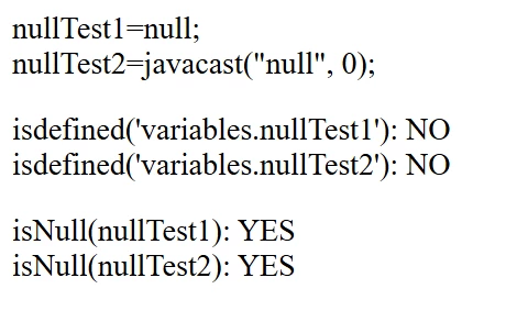

    Take the following code. for example.
    <cfscript>
    try {
    	nullTest1=hull;
    	nullTest2=javacast("null", 0);
    catch (any e) {
        //Dump exception
    </cfscript>
    <p>
    nullTest1=null;<br>
    <p>
    <cfoutput>
    	<p>
    	isdefined('variables.nullTest1'): #isdefined('variables.nullTest1')#<br>
    	isdefined('variables.nullTest2'): #isdefined('variables.nullTest2')#
    	</p>
    	isNull(nullTest1): #isNull(nullTest1)#<br>
    	isNull(nullTest2): #isNull(nullTest2)#
    </cfoutput>
    Run it in turn with this.enableNullSupport = false; in Application.cfc, then with this.enableNullSupport = true;
    With this.enableNullSupport = false;, the result is:
    Whereas, with this.enableNullSupport = true; the isNull() test results in the exception "Variable NULLTEST1 is undefined.". This is the kind of behaviour I consider counter-intuitive. Which is why I use this.enableNullSupport = false; in my ColdFusion applications.
