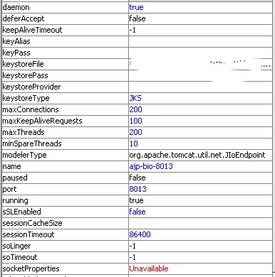

I have watched your Connect session several times. Most helpful, thanks. It gave me the insight, via JConsole, to see the results of changes to connection_pool_size / maxConnections and connection_pool_timeout / keepAliveTimeout. I'm guessing that I won't see any entry in JConsole for max_reuse_connections as my understanding is that this setting is part of Adobe's customisation of mod_jk?
My issues still stands. I now have lots of information (metrics.log and JConsole output) but no knowledge of how to use it to inform worker.properties / server.xml settings.

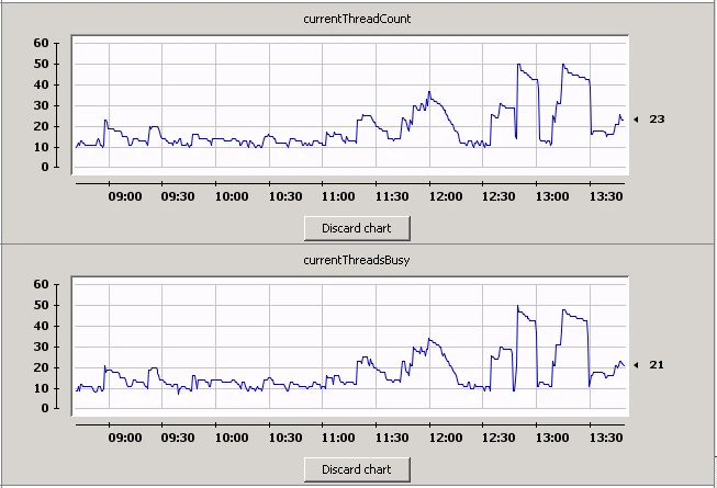

I'll capture a day's worth of currentThreadCount / currentThreadBusy chart data and post it back here with my worker.properties / server.xml settings later today to aid the debate.

As promised, here are some screen grabs from a good period of activity...
The worker.properties and server.xml files for the instance are unchanged from the default install (max_reuse_connections=250 only).
My interpretation of this is that thread count reached a maximum of around 50 which is well within the maximum allowed of 200.
The result I can't explain is that the thread busy count seems to be dropping as soon as the thread is no longer in use. The Tomcat Connector docs (http://tomcat.apache.org/connectors-doc/reference/workers.html) state that the default value is indefinite (zero). I've not added a value for connection_pool_timeout so I'm guess the Adobe mod_jk is adding the -1 for keepAliveTimeout which I'm also guessing mean "drop as soon as unused"?
I hope this helps inform someone who might be able to make some sense out of all this! :-)
