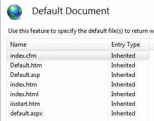

    add index.cfm in the default document at the top in IIS. Then you will be able to access acme.com/aboutacme/ from ColdFusion 10.
    VJ
