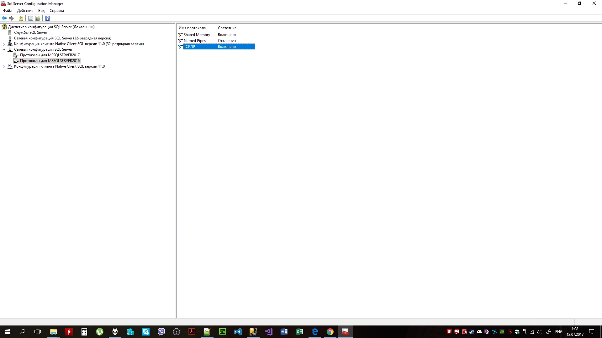

Shpak Aliaksandr
Jul 11, 2017 10:09 PM UTC
go
Sql Server Configuration Manager
C:\Windows\SysWOW64\mmc.exe /32 C:\Windows\SysWOW64\SQLServerManager13.msc
     SQL Server Configuration Manager | Microsoft Docs
you need find TPC/IP and active he;
