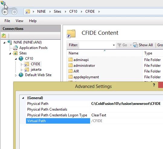

    Hi RLS,
    I believe you are using IIS with your ColdFusion.
    Can you please check if you have CFIDE and Jakarta listed in your IIS Website(s) with which you ahve created the connector.
    If not, please create a Virtual Directory in the webroot by the name of - CFIDE and point it to ColdFusion's webroot (<cf_install_directory)/\cfusion\wwwroot\CFIDE) .
    Can you also check if this website in IIS shows directories from CF 8 as well (like Cfdocs folder), I am guessing as you had CF 8 installed, probably the Configuration files from CF 8 are still there and conflicting you application.
    Let me know if the problem persists.
