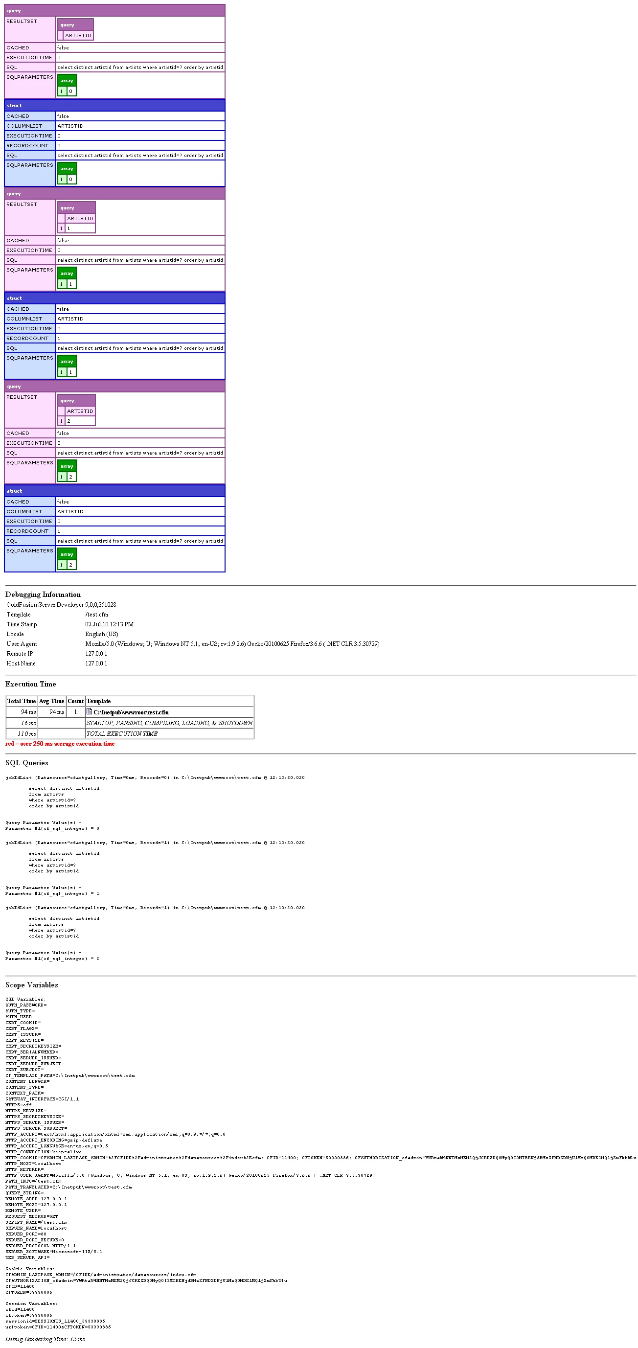

    When I ran a similar query against the cfartgallery embedded derby database, I get the expected results.
    Message was edited by: Ian Skinner  Ok, that image is worthless.
