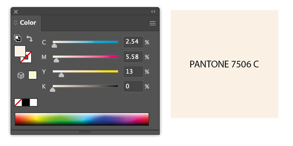

    Jun 19, 2023 9:12 AM UTC
    Thanks for replying!
    Please see my attachment. Is that what you meant?
    So if I go to my manufacturer, would I still tell them that the spot color is Pantone 7506C even if I played with tint?
