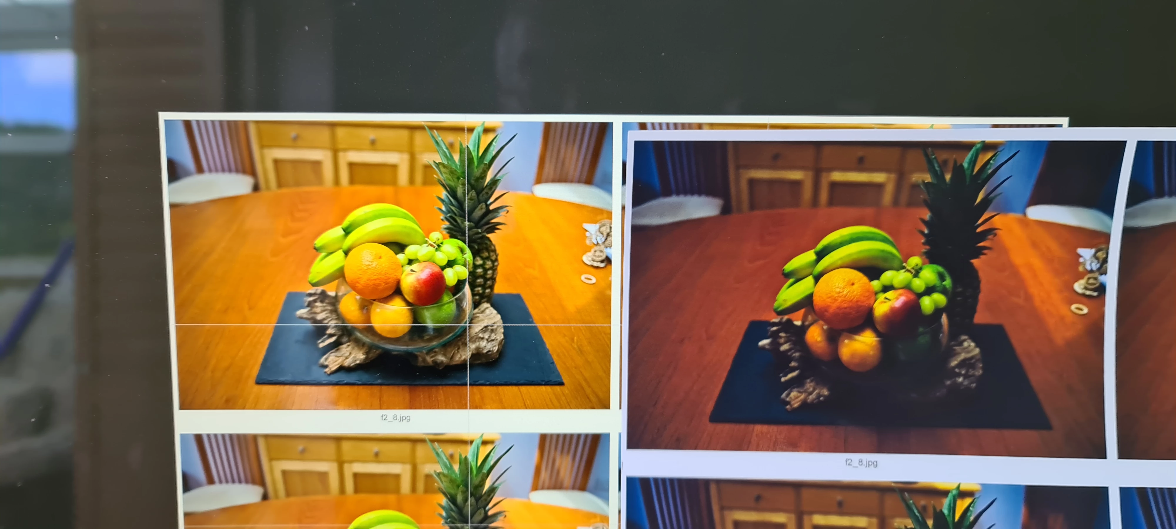

Hi Guys,
Which settings do I change to get what I see on the screen printed?
I have a Mac desktop and there does not seem to be any colour setting for the printer (that I have found yet).
Photoshop has an abundance of settings, but none seem to fit the 5520 printers.
Prints are printing with good colour match, but much darker than the screen - the attached picture shows a hand-held print to the right of its screen counterpart.
I am sure this is user (i.e. me!) error, but I have hunted the web and forums and not found a solution yet.
D Fosse
D FosseCorrect answer
Jun 16, 2020 3:12 PM UTC
If your prints are too dark, your screen is too bright. It's that simple.
You need to calibrate your monitor so that monitor white is a visual match to paper white, both in brightness and color. How you do that depends on what calibrator you're using. High-end monitors with dedicated calibration software have direct communication between them, so you set the white (and black) point targets in the software.
With third-party calibrators you don't want tto much adjustment in the 8-bit video card pipeline. So it's better to set it using the monitor's OSD menu.
Either way, it's a purely visual process. You want a visual match (given your ambient light, print viewing light and general environment). It's often recommended to start at 120 cd/m² and D65, that usually gives a rough match in most "normal" situations.
Once you have this basic match, it's time to look at color management and print profiles.
EDIT: Dave beat me to it, as usual, but you get the picture.

Jun 16, 2020 3:40 PM UTC
Thanks both for your help; Isn’t it easy when you know how?
In case others are also struggling this is what I did;
On your Mac, choose Apple menu > System Preferences, click Displays, then click Colour then Click Calibrate.
 The display calibrator assistant walks you through adjusting your display, then creates a calibrated colour profile. (It does say this is not necessary so you could use the default [iMac Calibrated] profile)
 Next time you are in Photoshop, click Print then, under [Colour management] [Printer profile] select the file you created in the line above.
 Magic happens and the prints are spot on.
 The only downside I can see is the printer profile has to be set for each print - it does not seem to be ’sticky’ between prints or between sessions. I do now have prints that are vibrant and match what I see on the screen.  Yay!
 Regards Paul

Hi Andrew
I've unmarked your answer as correct as it could mislead other people, and made sure D.Fosse's answer is highlighted as the correct answer. Your action may have got your colours closer but is not the correct way to colour manage.
The monitor profile and printer profile are two separate things.
What you did is not profiling. Whilst you can use a generic profile for the monitor - it can only be close to describing your monitor. To produce an accurate profile requires a hardware device which reads colours off the screen. So the profiling software sends a set of known colours to the screen and reads what actual colour is produced. That is used to build a profile describing your actual screen.
The printer profile describes the printer. It is produced in a similar way but with different hardware (a spectrophotometer). A monitor profile should never be used as a printer profile. The printer profile has to describe the behaviour of your printer using a particular paper and ink set. That will be very different to the behaviour of a monitor. Some folk use the equipment to produce their own printer profiles ( I do here) some use the profiles from the paper/printer manufacturer which are often quite accurate. You should never substitute a monitor profile for a printer profile.

Jun 16, 2020 5:06 PM UTC
Phew!  Thanks, Dave, a lot of useful content in that response.
Not being a professional printer calibrator or a professional monitor calibrator with NO hardware to hand and a clearly limited understanding of the topic is there a "good enough" solution to matching these profiles?
Certainly, pointing Adobe CC at the file the Mac colour calibrator produced (which I thought, clearly wrongly, followed your points 2 & 3)  has created a much more what-you-see-is-what-you-print (on my HP PhotoSmart 5520) than my earlier attempts however I do follow that the screen may not match reality and the printer and/or paper used may not match the screen with the profile I have used.
😞 Not easy is it?
D Fosse
D FosseCommunity ExpertCorrect answer

Jun 16, 2020 3:07 PM UTC
To get a good screen to print match requires colour management of the screen and the printer.
Three steps to heaven :
1st you adjust the white of the screen to match the paper (normally screens are set too bright)
2nd you profile the screen with a calibration and profiling device such as the i1 dsiplay or similar. This will store a profile describing exactly how your screen displays colours, in the operating system. Photoshop will use that profile.
3rd You use a printer profile that fits your exact printer/paper and ink combination and at the same time set the printer settings so that they match exactly the way they were set when the profile was made (the paper/printer manufacturer who supplies the profile should be able to advise on this.
