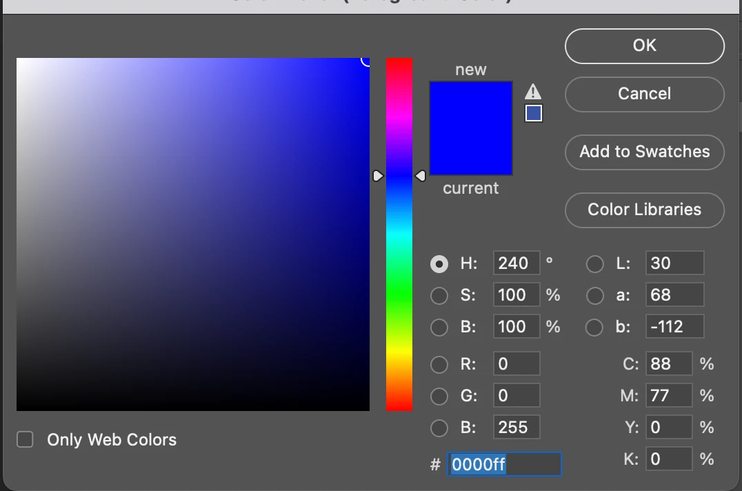

Apr 25, 2022 8:42 AM UTC
Hello, this is probably a shot in the dark since it's been 6 years, but I have the exact same issue, with the exact same colour (#0000ff in RGB), so I was wondering if you remember how you solved it? Thanks a lot !

Mar 25, 2016 2:17 AM UTC
That is an out-of-gamut color ( will not print ).  CMYK = 91C, 72M; RGB = 0R, 0G, 255B.  In Photoshop, my color picker averaged it out to a spot Pantone 072 ( dark Blue ).  On press, the only way to get that color to print is to find some fringe florescent spot color, Bright Blue ( hypothetical ).  Check around and look at different spot color ink manufacturers like TOYO and Pantone florescents.
