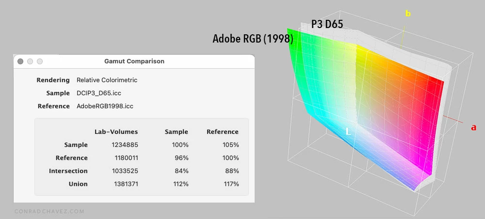

    An important thing to remember is that percentage comparisons of color gamuts are not very useful. The reason is that the 3D shape of real world color gamuts is not uniform, not a perfect sphere or cube. Their shapes are highly irregular. One misinterpretation from reading that percentage is to conclude that P3 covers fewer colors. But that is not true, or at least it’s incomplete, because it goes both ways. The irregular shapes mean that it is also true that Adobe RGB covers less than 90% of colors in P3.
    In the 3D comparison below, you see that neither gamut fully covers the other, so what they really do is cover different similar gamuts. P3 D65 is shown in gray, so you can see that over some colors it falls short of Adobe RGB, but in other colors P3 D65 extends further than Adobe RGB. So actually, neither is fully superior to the other…both are great wide gamuts.

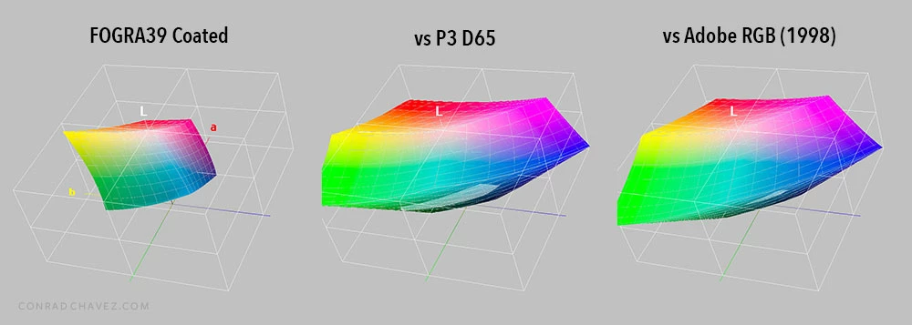

    Also, a percentage comparison tells you nothing about how well the display color gamut covers matches up with the gamut of the ink and paper combination you will use. What you see below, left to right are: First, a common CMYK print gamut (Coated FOGRA39), then how much that print gamut is covered by P3 D65, then by how much that’s covered by Adobe RGB. What you see is that both P3 D65 and Adobe RGB cover almost all of that Coated FOGRA39 print gamut, and both can’t reproduce a small portion of Coated FOGRA39 extreme blues/greens (the little bit shown in gray). What you don’t see is that if these were rotated, on the other side both P3 and Adobe RGB can reproduce all of the warm colors in Coated FOGRA39.
    In general, what this tells you is that Adobe RGB can reproduce slightly more print colors than P3. But whether that difference is important depends on what colors are in your images, and what printing conditions you need to target. For example, this comparison has different results when compared to uncoated FOGRA39, and different again when compared to the color gamut of my inkjet printer.
    Most of the time you’ll find P3 D65 is just as good as Adobe RGB, and depending on the colors in the image and the print color gamut, maybe sometimes better.
