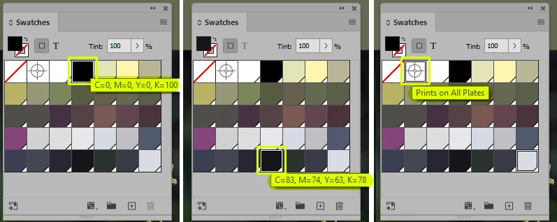

Here's the 3 different types of black in InDesign:
The first, to the left, is 100K black, prints on the black plate only, and, crucially, overprints the other plates. Routinely used for text.
The second is rich black, or 4 color black. By using all four inks you get a deeper black - but there's a catch: you absolutely must make sure you're not exceeding the total ink limit for the particular CMYK profile you're working in. The numbers here are the ink limit (TAC) for ISO Coated 300% (eci). That's the deepest black you get. Any more ink, and you get smearing and drying problems.
Which is why you can see that the third, registration black, is an absolute no-no. It prints 100% on all four plates. That's OK for registration marks, but absolutely not in the document.
