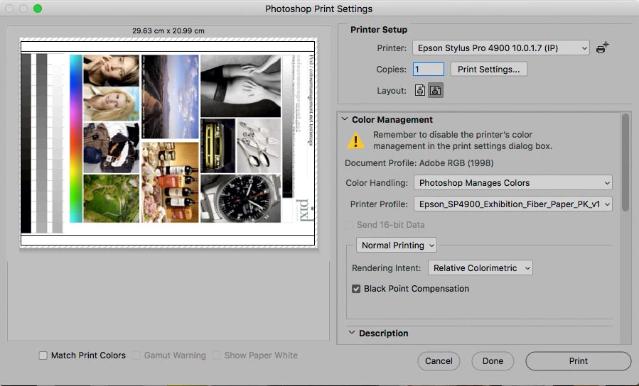

    Using profiles with Photoshop
    When printing with printer profiles, it is an absolute requirement that you’ve set your printer driver settings exactly as they were when printing the ICC patches used for building your printer profile. And it’s equally crucial that you print on the same type of paper, and use the same type of ink.
    These are some mac screenshots I had handy.
    To print images from Photoshop , the easiest way is to simply choose File > Print, and in the resulting window set it as suggested here. First set color handling to : photoshop manages colour
    next select the relevant ICC profile. Maybe you downloaded it from Canon?
    [this example is for an Epson 4900 with Exhibition Fiber paper, so the profile for that paper is selected]:
    on a mac we click "print" to open print settings. [on windows its part of printer properties. it will look similar to this - as far as options goes]
    its important here to set the media type correctly and then the other settings such as resolution should be the same as those used when making the profile.
    If the ICC profile maker has not given you that info then best start by testing the defaults for the media type.
    I hope this gets you off to a good start,
    of course the ICC profile needs to be good or it's not going to help to use it.
