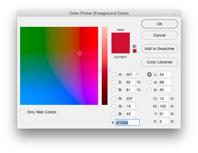

    When getting conversions you also have to be careful about the source definition for the Pantone swatch. Photoshop has always used Lab definitions for the Pantone libraries—the Lab values come from instrument readings of  printed solid color swatches.
    Starting with CS6, Illustrator and Indesign made significant changes to their Pantone libraries. Prior to CS6, the ID and AI libraries used CMYK definitions for the Pantone swatches and part of the transition allowed you to choose between Lab and the legacy CMYK. The CMYK defined swatches are impossible to correctly color manage so now the solid libraries are Lab definitions only, and there are new libraries for process CMYK simulations of the solid inks—Pantone Bridge.
    So to get the sRGB hex value for 186 Coated, make sure the source is the current lab value for the color (45|68|40). Here in the latest Photoshop with no documents open, and my Color Settings set to sRGB:
    The Picker will give the correct conversions to my settings' current working spaces. Note that the CMYK conversion also depends on the Settings' color intent and Black Point Compensation:
