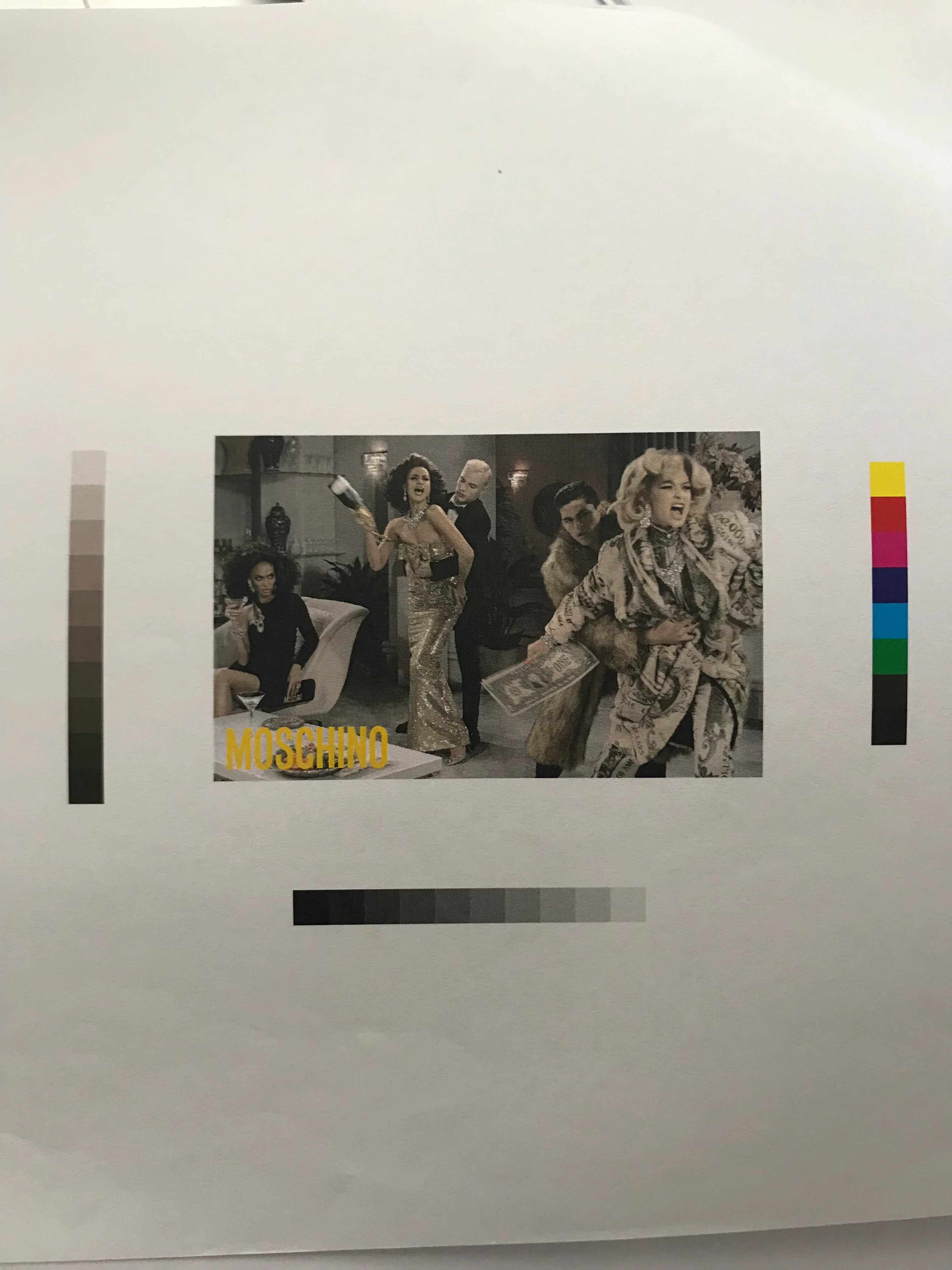

    Here is an example of "muted" colours. However the calibration bars print out. This is using the RGB profile I had made. This is what makes me think it must be a CMYK pipeline.

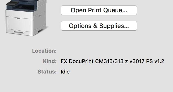

    Blake, yeah BUT it MAY be a Postscript (therefore a CMYK) driver

    Yes it is a Post Script Driver from Fuji Xerox that I have been using (even says it in the driver file name - screenshot attached), But can't a Post Script driver be an RGB driver not strictly a CMYK driver? For example this Post Script driver has an RGB adjustment option in the advanced driver menu (also screenshot attched). Fuji Xerox also have a PDF driver which I also have but I dont use because the printer driver menu is very limited and more generic...

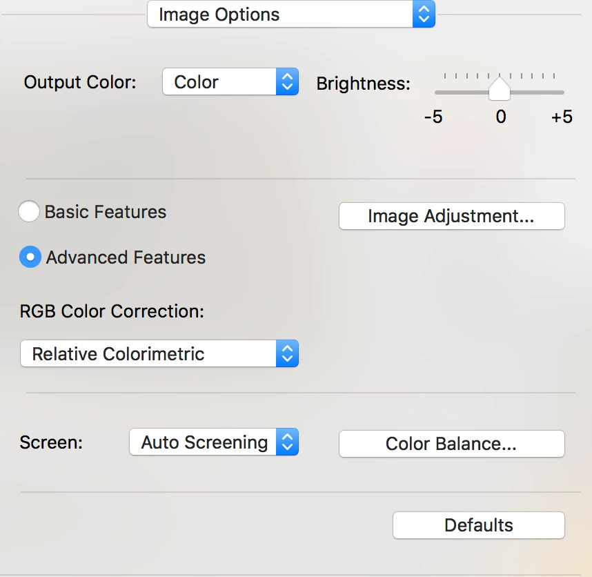

    Yeah maybe. But I only have this muting happen when I print from Photoshop using Photoshop colour management with Fuji Xerox printer driver corrections off, and its not only when I use the RGB profile I had made, it happens when using any RGB profile like Adobe RGB and sRGB IEC61966-2.1 for example. Only CMYK profiles have worked using the same workflow.

    It's somewhat likely a the Xerox driver IS a postscript (so, CMYK) pipeline.
    [for more on testing this please see: https://community.adobe.com/t5/photoshop-ecosystem-discussions/determine-if-a-printer-is-rgb-or-cmyk/m-p/10845040]

    You mention muted results when printing using the RGB profile you made on Mac, could that be a Xerox Mac driver issue (settings?), perhaps its doing some CM in the background? I guess there's also a Xerox printer calibration process in the driver, so make sure that’s done right if your machine allows it.

    I am using the provided Fuji Xerox drivers for the same printer (Mac & PC versions). But they aren’t 100% identical (e.g. a setting may be the same but called something different), but I'm sure I have matched all settings to be the same. Colour corrections are turned off and paper and toners etc are also the same.
    Thanks Neil for the test image but am still noticing the same differences.
    I actually only wanted to create a profile for my Mac but I wasn't able to print a CMYK tiff (to create a CMYK profile) as the page comes out blank with no toner on the paper at all. So this is the reason I involved a PC as a CMYK tiff will print from ACPU.  So I was hoping to create an icc profile from a chart printed from PC to use on Mac for this reason.
    I didn’t have this problem when creating an RGB profile for my Mac, but the problem was when trying to print using it (or any RGB icc profile) in Photoshop (with colour management off in driver) the colours came out muted (almost colour blind looking) but not the case when using any CMYK icc profile with the same workflow. Hence why I wanted to create a CMYK icc profile to get around the issue. Then only other way around it was by embedding the RGB printer profile into a PDF and then printing from the Preview program.
