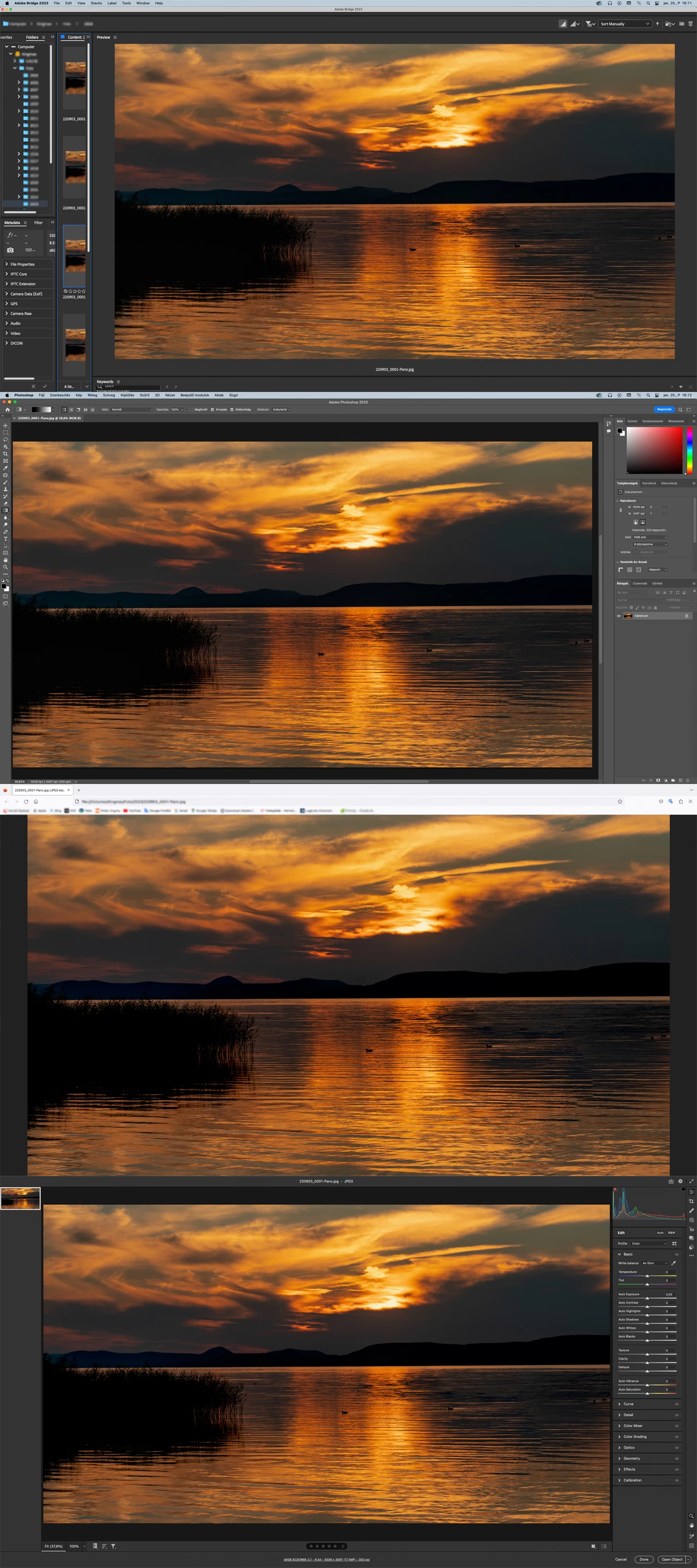

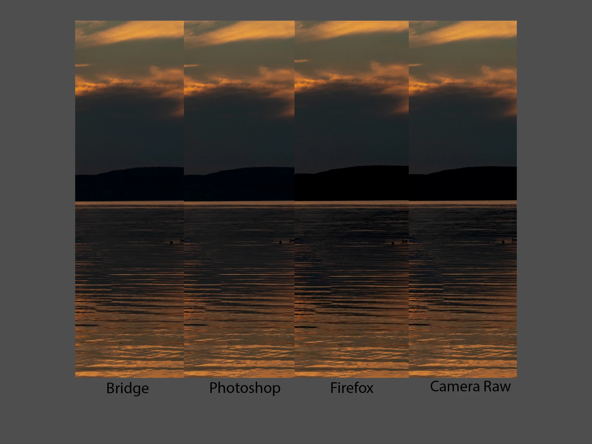

Hi There,
I'm on Mac Mini M1 OS 13.1. Acer XV272U 120 Hz 10 bit (8 bit FRC)
I faced a huge mess about the color rendering of Ps ecosystem.
I opened the same JPG pic. in Br, Ps, Firefox, ACR and I visibled different color rendering. See attachment.
Could anybody explain me the reason of this phenomenon? Please, avoid color management tutorials. I have proper color managed system.
Ati

    D Fosse
    Jan 23, 2023 3:49 PM UTC
    Similar, but not identical. ACR and Firefox show some black clipping not present in PS or Bridge.
    I'm fairly certain this is a monitor profile issue. This is a quite common smoking gun.
    One more thing: always compare at 100%  Different screen resampling algorithms may influence the result.

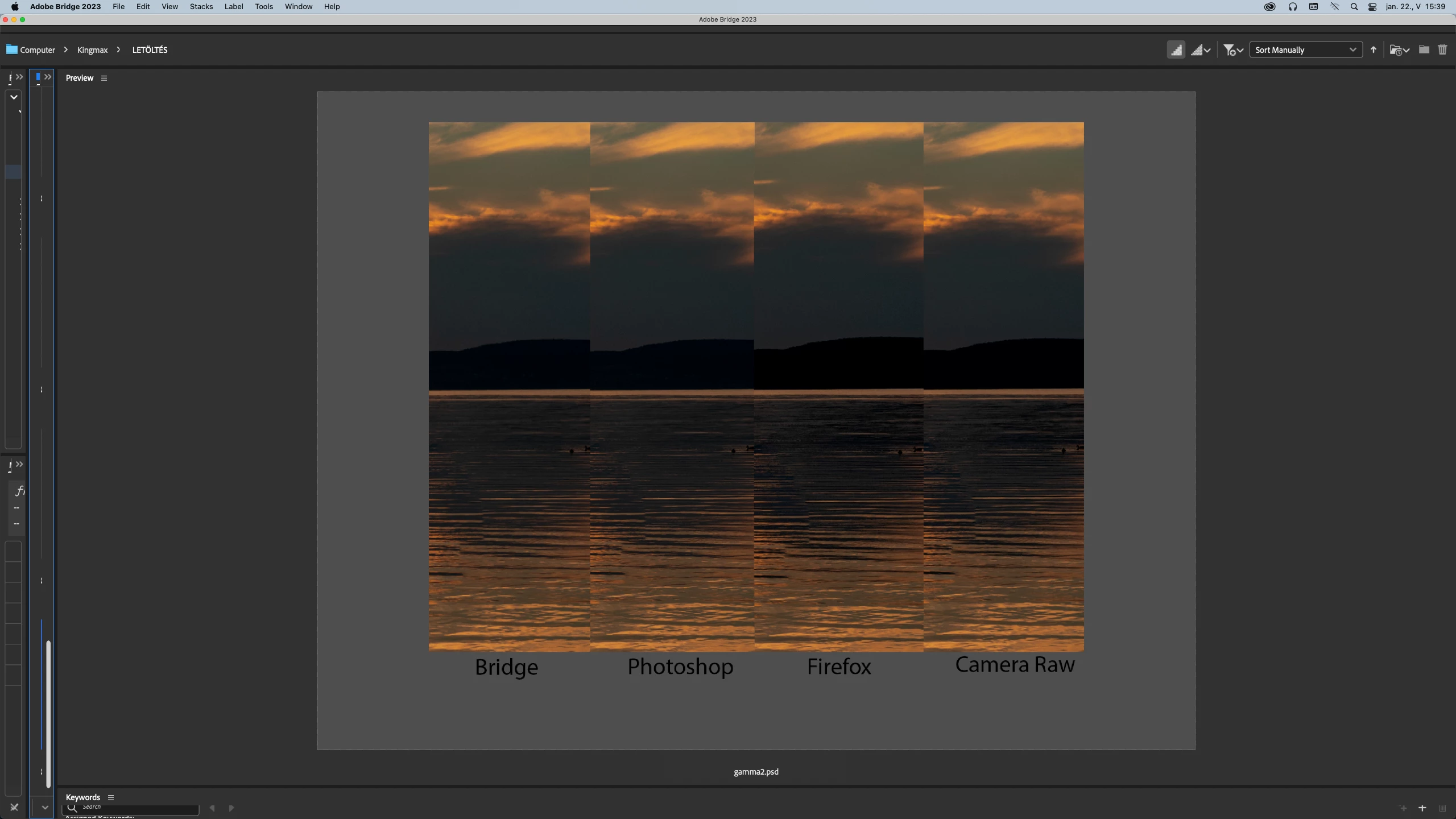

    st-ati
    st-atiAuthor
    Jan 22, 2023 3:29 PM UTC
    See the pics in Ps or Lr or Br, not in browser.
