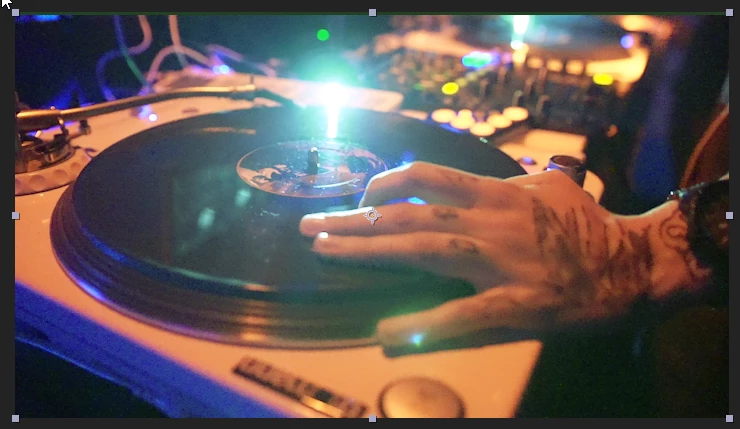

Hallo liebe Adobe-Community,
seit längerem beschäftigt mich die Frage, wie es manche Leute hinbekommen, einer Person im Club ihre menschliche Farbe zurückzugeben, statt sie einfach nur in Rot/Grün/Blau mit den Lichtern flackern zu lassen. Bei diesem Bild Beispielsweise verfärbt das Disco-Licht die Haut sowie Pult rötlich, und auch wenn ich die Hand selektiere und noch so sehr mit der Farbkorrektur herumspiele: Eine Hautfarbe kommt nicht zu Stande.

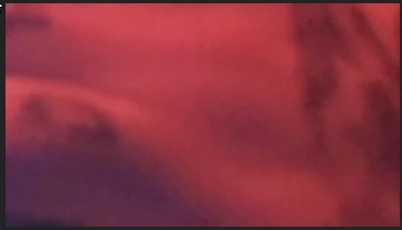

This is one of those times when the video colorists have the advantage over the photographers. They have the scopes to do color correction. I imported the image to After Effects and zoomed in to the back of the hand. The YUV vectorscope looks like this :

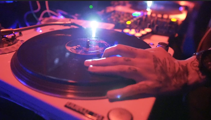

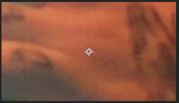

The faint diagonal line running top left to bottom right is the aim line for skin tones. Suprisingly that skin tone line works regardless of the person's colour. So, using a curve, I upped the green to bring that tone across, and dialled up the saturation slightly:
Unfortunately we don't have the same controls in Photoshop but we do have curves so a similar boost in green and minor increase in saturation will do the same job but without the scope it is down to eyeballing it.

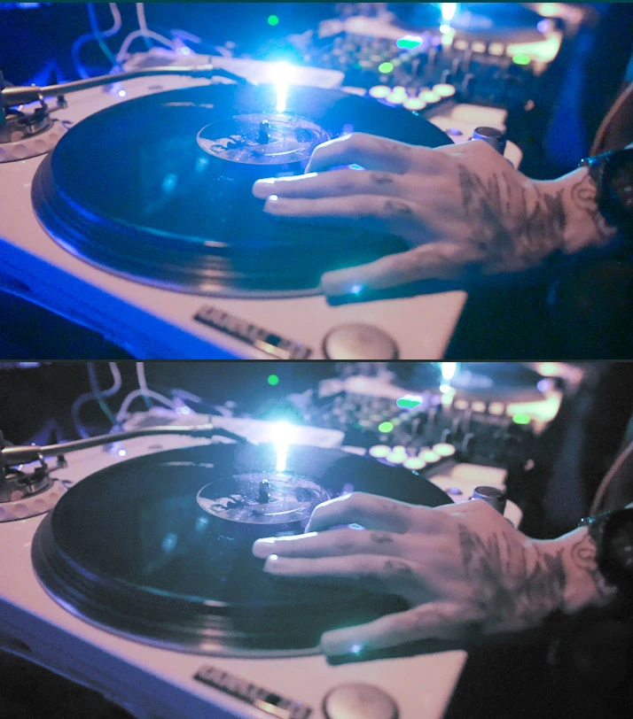

Just to give you an idea (this is not an attempt at correcting the image).
White balancing the top of the turntable - assuming it is supposed to be more or less neutral - causes blues and cyans to completely explode. Dialing blue and cyan saturation almost all the way down gives this:
Hardly very natural skin color...
