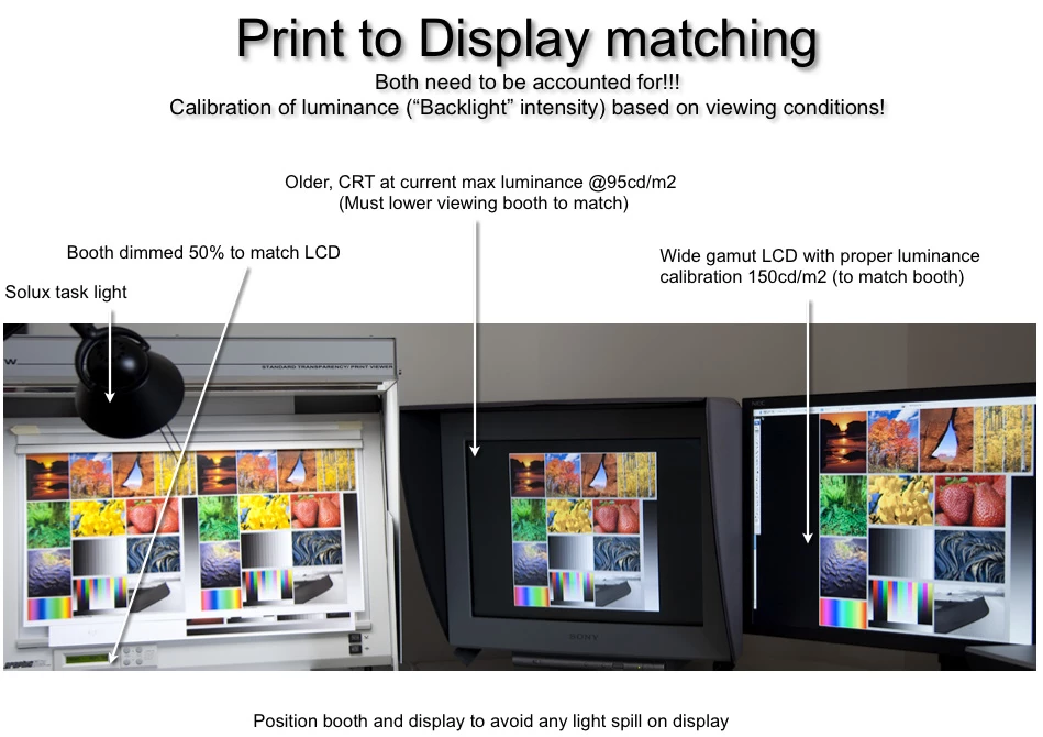

    About Luminance or Lux values in a room used for photo editing. I'm just trying to get as much information as I can so I can speed up my calibration process.
    Lux Meters can be costly, starting around $150 USD. I would imagine that you get what you pay for!
    I did see an article on how to use your Smartphone to measure Lux, has anyone tried this?
    Is there an ideal Lux value range one should be targeting?
    TheDigitalDog
    Sep 13, 2020 3:18 PM UTC
    KISS: don't waste your money and time. Keep the ambient conditions AS LOW AS POSSIBLE as outlined by Karl Lang. You don't have to worry about a LUX meter.
    Author “Color Management for Photographers" & "Photoshop CC Color Management/pluralsight"
    Sep 14, 2020 1:38 PM UTC
    All I can say is that all information is good if one is willing to learn!

    Colornavigator supports the i1Display Pro sensor out of the box. I've been using the i1D3 with Colornavigator for a long time.
    In matching screen to print, setting the black point is just as critical as setting the white point. You must set the black point carefully! It should be a visual match to max ink for the paper - just as the white point should be a visual match to paper color.
    The black level is responsible for most of the perceived "punch" in the finished result. Minimum is fine for video or web, but it will not work for print. No print process can reproduce blacks that deep. For inkjet prints, a black level of around 0.4 cd/m² is a fairly typical number, but for offset print you may need to go as high as 1.2.
    BTW - the Spyders are better than their reputation. Datacolor dump their off-spec units in the cheap "express" edition (which a lot of people buy just for the sensor). I've had a few Spyder sensors over the years, and they have all been good - except the express ones. That said, I do prefer the i1D3. In any case, the Eizo-branded units have tighter specs than the stock units.

    In color managed applications, the gamma or TRC of the display has no bearing.
    Print viewing conditions are super important of course and must correlate to the cd/m2 of displa calibration:

    Your "Print to Display Matching" infographic is telling me that my room is too dark, and needs to match the luminance of viewing conditions? So not to be redundant, please read my response to Bob's post!
    Believe me when I tell you that very people use a Viewing Booth due to the expense. With that being said, is there a way to know when one has accomplished ideal viewing conditions?
    Another note, it's ironic to me that only 2 people in the photography club I belong to calibrate their monitors, and they get really good prints, why is that? The other person that calibrates uses a Dell monitor. The others don't use the more expensive monitors, and some use laptops. Don't get me wrong, but I think calibrating is a good thing if one wants better results on print.
