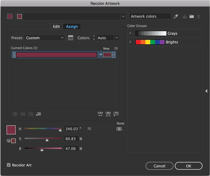

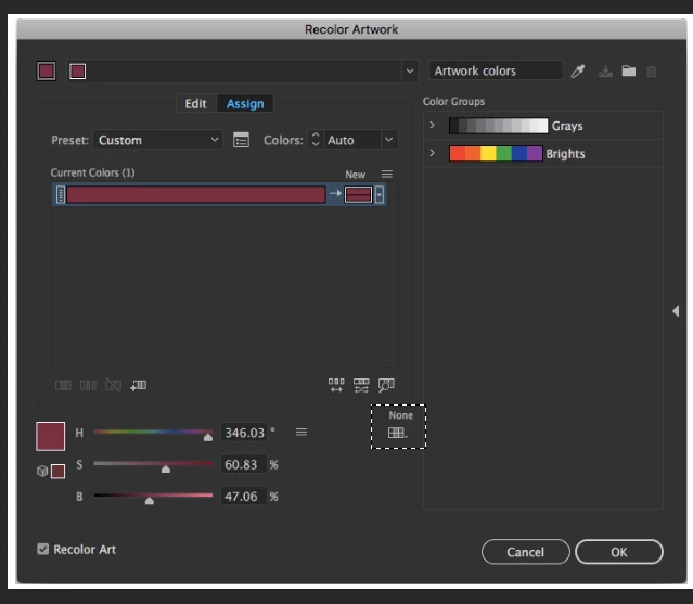

Your explanation sounds fairly easy to follow. However, I am fairly untrained in Illustrator and am missing some options that you mention. Specifically, I do not see Color Books and I can't find a way to view Pantone colors. Is there some sort of add-on I have to upload, or an integration to facilitate? I'm entirely new to the world of color and printing. Thanks in advance!

Hey Matt,
You'll find the color books option once you click on the tine box below None. Choose Pantone Solid Coated and then hit OK.
