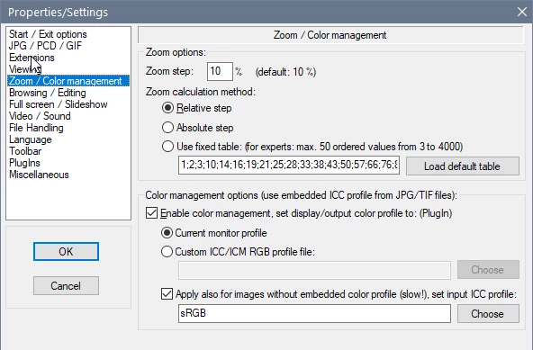

Thank you for the detailed info!
I forgot about the embed profile, changing this fixes the problem inside of photoshop.
Investigating further the IrfanView settings now work too, the plugin wasn't installed... After installing it IrfanView works as expected. Afters some tweaking Firefox too. Only chrome isn't there yet. But now I at least know the root of the problem.

May 20, 2020 8:36 PM UTC
Have you enabled color management in Irfanview?
If not, go to Options > Properties/Settings and enable it, then restart Irfanview.
Chrome is color managed out of the box, and should display the same as Photoshop and Lightroom.

May 20, 2020 10:01 PM UTC
Thank you for the quick reply!
I haven't had the IrfanView cm enabled yet, unfortunately it didn't change the result.
The monitor profiles were created using DisplayCal (recent version) and an i1 Display Pro (the older Rev A). I am using their profile loader, which constantly checks if the profile is still loaded - it also shows up correctly in Windows color dialog.
