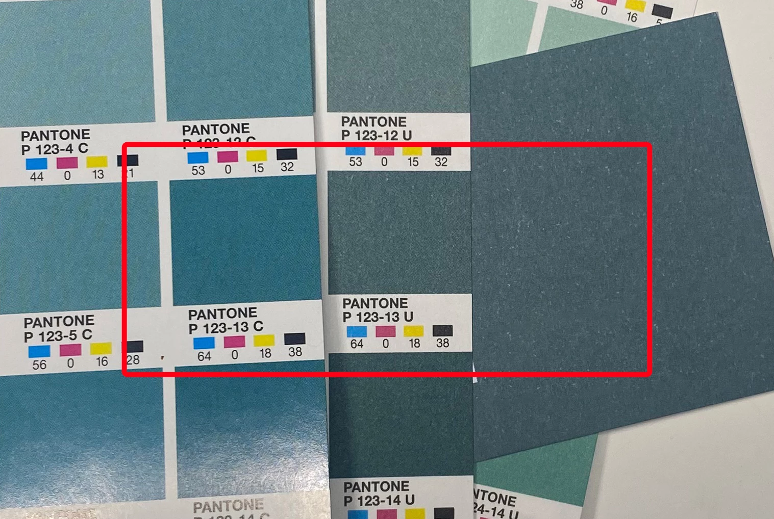

Hi, I have company stock (business cards, etc.) printed on uncoated paper. It has a very unsaturated silky look and we're totally happy with it. We now need to produce rollups and other products that have a coated surface and I am struggeling with the colors.
I'm using pantone cmyk color guides to compare colors from uncoated to coated but can't find a match that's at least somewhat close. Same values naturally look completely different (pic attached) but I can't find anything in there that would be even close.
Any tipps are appreciated! Thanks

    The proper way to make this work is if your uncoated printing was at a standard. The uncoated standard in the US is CRPC3 in Europe Fogra 47.  If the uncoated work you're trying to match was printed to one of those standards you will be able to match that on coated printing by opening the image in Photoshop and assigning one of those 2 profiles above.  Then convert to the coated profile standard your printer is using.  There are many standards for that but Sheetfed Offset coated in the USA is CRPC6 and in europe it's Fogra 51.  This will keep the color apperance of the first profile (uncoated printing) and allow you to either get closer or match that on coated papers.

    Thank you all for your inputs. I don't know the printer and on my request I just got a pdf with the info that document colors should be cmyk and iso coated v2 … so there's that.
    I decided to go with Bob_Hallam's approach to get as close as possible and then vary the colors, make a grid and let the printer produce a sample on the actual material. Gonna go pick it up this week … we'll see.

    You need an ICC profile for each stock and printing condition. The only ones who can help here are the printing suppliers.
