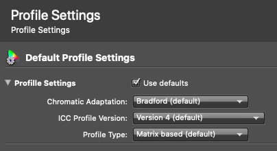

    Forget V4 ICC profiles. There never was a V3, just select V2.
    V4 do have extra features but many of those have not been adopted by software makers, so using them seems to confer no advantages, just add potential issues.

    So long as it's a good version 4 profile (Xrite profiles are) there are no drawbacks to using v4 profiles and definitely benefits in color rendering.

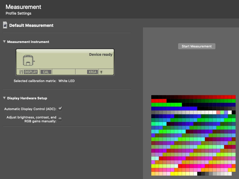

    ruggero.carrara
    April 7, 2020
    Hello Fosse,
    so, this is what I did following your suggestions:
    • Deleted all the profiles.
    • Reset the monitor colors.

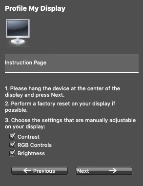

    • Set the monitor color profile to the original one from the manifacture that it always seems tending to magenta.
    • I let come in some light through the window (2pm) and setted up the white point of the monitor, with the monitor controls, to match a white paper that I have here, is just a normal white board, I have nothing else but it seems pure white to me. RGB values: 95 - 100 - 96.

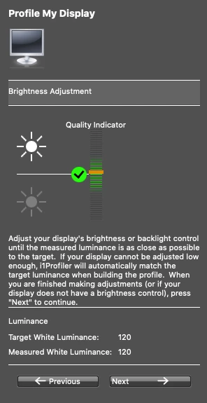

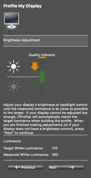

    • With the i1Profiler software setted up the luminance to 120 cd/m2.
    • i1Profiler settings set to: White point "Native"; Luminance "Native"; Gamma Standard 2,20; Contrast Ratio "Native"; Flare Correct NO; Ambient Smart Control NO; Profile Settings Adaptation "Bradford", "Version 2", "Matrix Based"; Patches "Large 461".
    • Darkened the window and all light sources.
    • Run the measurement.
    At the end it seems fine to me, but I'm wondering if the White point Achived is correct, CCT: 7033K.
    As NB__colourmanagement said yesterday: "The generally usable range for whitepoint is between 5000K and 6500K so stay between those parameters unless you have a very good reason to stray outside that range.".

    • also close down i1Profiler and delete all profiles. Start from scratch. Set a white point in the monitor that looks neutral to you. Use the on-screen menus in the monitor. Nevermind what the settings and numbers end up as, just get it to look right.
    Next, start the pre-calibration function in i1Profiler where you set luminance while the software monitors the level. You still adjust it with the monitor's on-screen controls, but the software measures and reports as you go. Again, a good starting point is 120 cd/m².
    When this is finished, the monitor itself should be set up correctly. Now the calibration and profiling can start, while using the white point already set in the monitor.
    The white point then needs to be set to "native" in the software, both for luminance and color (temperature).

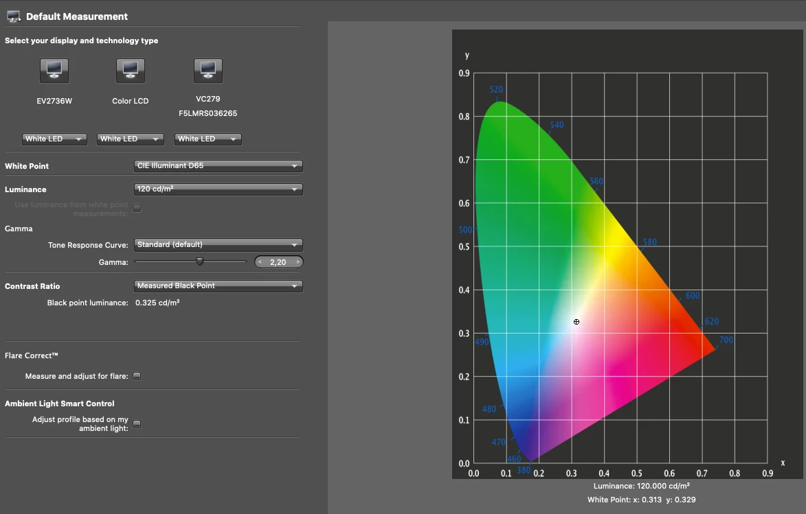

    ruggero.carrara
    April 6, 2020
    Hello to all!
    I hope you guys are doing good and safe.
    I reset again the monitor and the native color profile of the monitor to try again with these settings:
    • White point D65, you all said to try with a different color temperature, do I have to put it here right? There is an option also to measure this with ambient light or a peace of paper, should these be other solutions?
    • Luminance 120 cd/m2.
    • Gamma standard 2,20.
    • Contrast Ratio measured with a black patch on the screen, shuld I use the "Native" option?
    • Measure and adjust for flare, not checked because I'm in almost darkness to make this calibration.
    • Ambient Light Smart Control, not checked because to do this calibration I switched off all the lights and the other screens, should I activate it later?
    • Profile settings, I changed just the Version 2.
    • Patch set size Large 461.
    • RGB monitor settings to match the software suggestion: R97 - G100 - B94.
    At the end, is still too green to me.
    I will try again with DisplayCall now in a different User profile.
    Thank you so much guys!

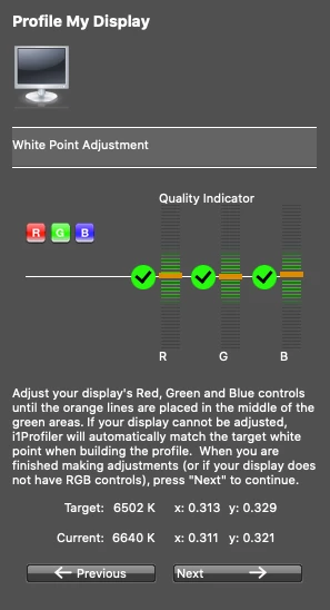

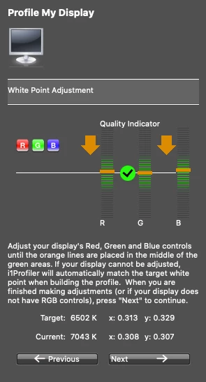

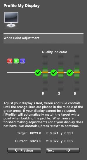

    ruggero.carrara
    April 6, 2020
    New test still with i1Profiler, the only things I changed are:
    • White Point Daylight Temperature 6000.
    • Contrast Ratio Native.
    • RGB monitor settings to match the software suggestion: R98 - G99 - B90.
    But at the end, when I save the color profile, everything become too yellow/green.

    Yes, that's expected given the advice you are being given.  Sorry.  Use V4 profiles they will be the most accurate.  The contrast ratio is native that's fine.  But try just calibrating to the native ambient light.  Using the ambient light option in the software. 120 cd/m2 is very bright and will wash out the color in a dim room.  Change that to 100 and see if the contrast is closer.  Adjust this value if the shadows are still too open to be less bright.  or you can brighten the room a bit if that's an option   Moving the white point back towards 6500k will make it bluer and back towards 5000k will be more yellow.

    Try a white luminance target level around 120 Cdm2 - your room light should be subdued which would make that acceptable.

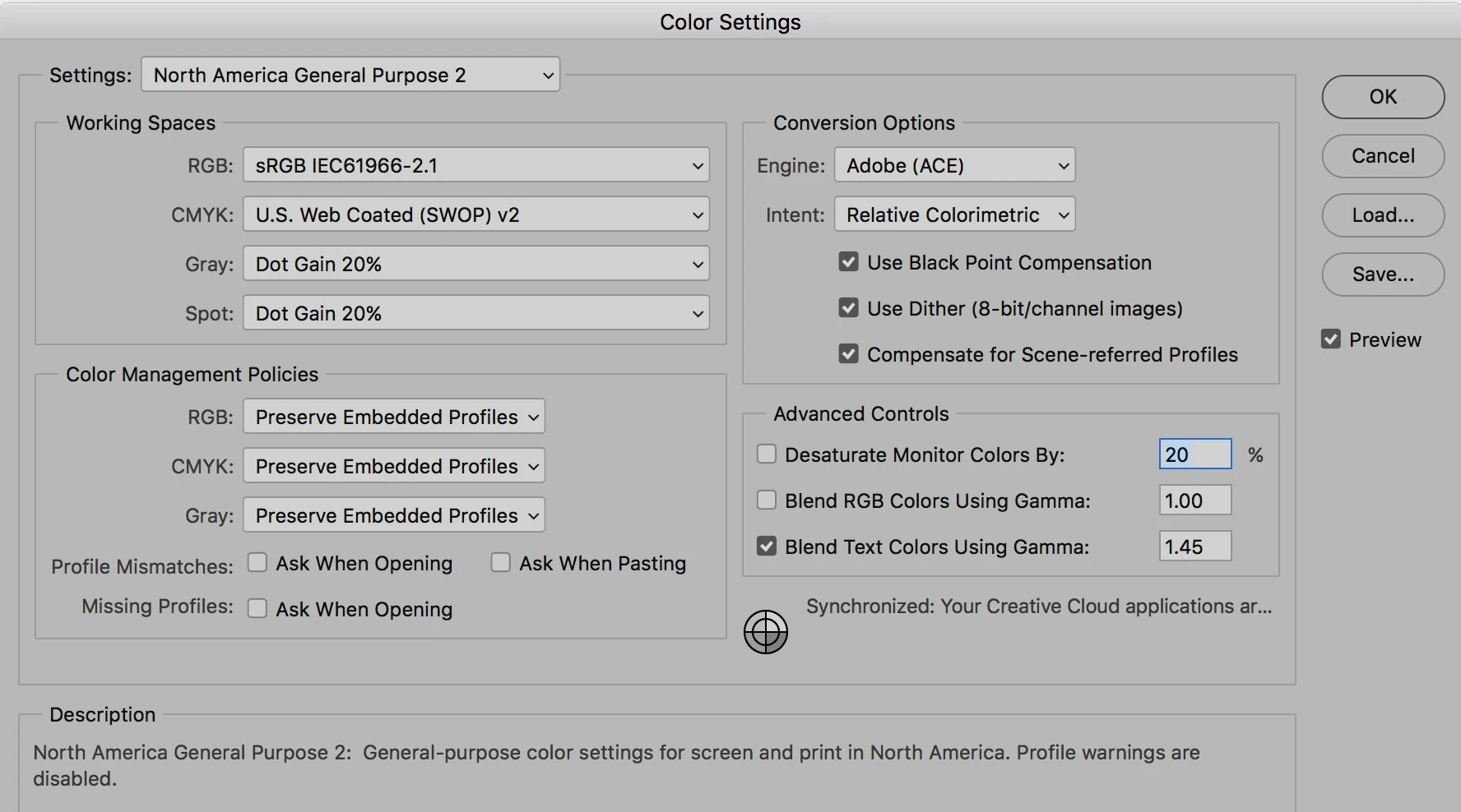

    Photoshop 'color settings' are specific to your type of work,
    in any case the settings for workingspace RGB and CMYK are only defaults for newly created documents.
    Not for images you open. The color management policies need to be set right though.
    Screenshot the current settings you are using post that here
    and tell us what kind of work you do, where the images you use are from etc.
    Is your work going out to clients, if so for what use?

    I asked you to post a screenshot of your color settings dialog box please, see example below.
    You could leave on default as advised elsewhere here, of course you need to know what default settings are if you've been messing around there, generally that's "North American General Purpose"
    As I explained the, most important settings are the policies, D Fosse has told you what to do there.
    The story is with this "color settings" dialog is leave it be unless you understand what you're doing - the advice of well meaning Internet exchanges may be flawed, mostly that doesn't apply to here, but it can.  Look for advice from an ACP, that's generally good.
    Changing things there without understanding potentially results in chaos
