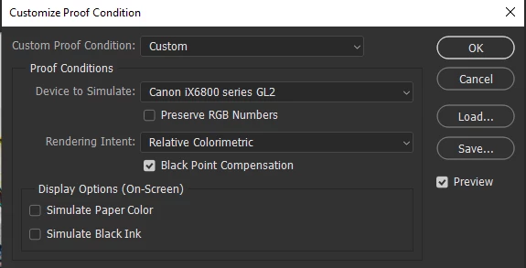

Hi - I'm having some issues with gamut/proof and printing. In the first image, I have my proof setup to simulate my Canon Pixma ix6850 printer (using glossy paper) - so using the Canon iX6800 series GL2 (for Glossy paper).

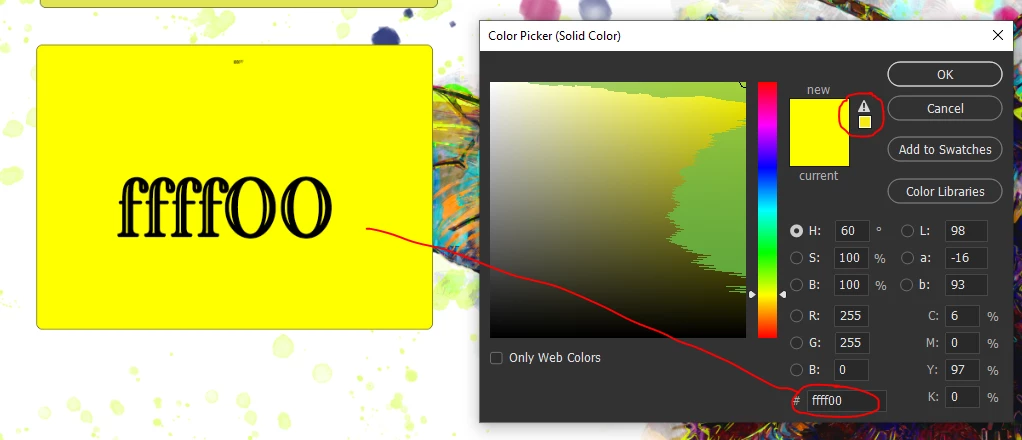

In the third image - you can see the colour #FFFF00 - pure yellow on screen - and a Gamut warning. So I'd assume that wouldn't print ok.

Have I misunderstood Gamut - in that if it flags in the colour picker, then it will NOT transform correctly from screen to print?

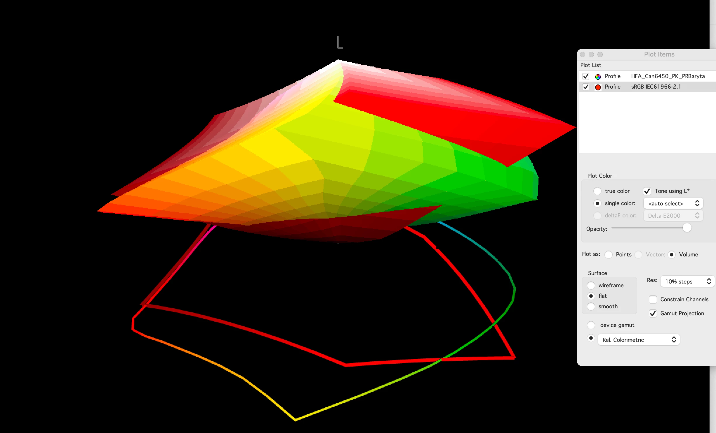

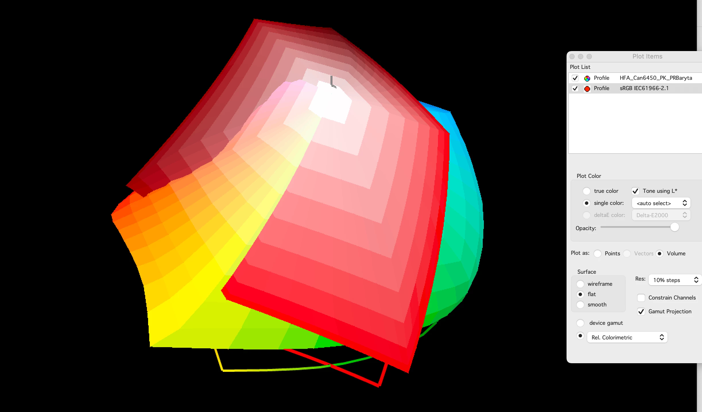

    Having the profile to compare would be great.  Glossy stock is a very generic term.   Most profiles are created for specific stocks, so If you have the paper and profile that's best.  Good printers on nice coated stocks from reputable manufacturers can easily cover sRGB color space.  As a matter of fact, the US  sheetfed Offset print standard gamut is larger than sRGB so it's quite possible to cover this space on coated papers.   Here's one example from Hahnemuehle, whose papers I'd recommend as excellent.   Where you can see your issue.  The yellow-green colors are outside the gamut of the profile.  So your gamut warning is accurate, just give perceptual rendering intent a try, to see how that yellow-green color is mapped back into the printer's gamut.  If it's acceptable, you're good to go.  If not I'd suggest trying a larger gamut printing process.  Epson printers with 12 or more colors will cover that gamut without a problem.
    Even YOUR gamut maps here show that isn't true.
    Please plot a printer next to sRGB where the printer fully encompasses sRGB. Otherwise, I'll stick to my statement that no printer can print all of sRGB. There are actual, visible colors IN sRGB that no printer can produce.
    Since this is a forum on color management, you might wish to rephrase your statement and use gamut volume to correctly imply that there are printer gamuts that are larger in some areas of color space, often by a lot, than sRGB. But the statement above and your gamut maps do not.
    Good printers on nice coated stock cannot easily cover sRGB color space. Those are colorimetric facts your gamut maps clearly show. As a matter of fact, the US sheetfed Offset print standard gamut is not larger than sRGB in some areas of color space.

    Andrew, my gamuts were not there to show the truth of that statement.  They were there to show the problem the OP is having and help.  Please do read.  In this thread, I'm helping the OP.  If you have a problem let's address that in another thread, please.  I've shown that statement to be true many times already.  You can go back and check.
