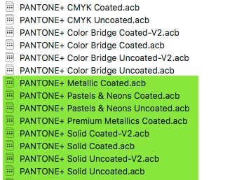

    Jun 11, 2018 3:17 PM UTC
    Also, starting with CS6 and with the CC print applications, there is a clearer distinction between the solid ink (spot color) libraries, and libraries that are CMYK 4-color simulations of the solid ink spot colors.
    The CMYK process color simulation libraries are now named with the PANTONE+ Color Bridge prefix:
    The solid, metallic, and pastel spot color libraries do not have the PANTONE+ Color Bridge prefix—these colors will normally output to a separate press plate unless you are printing to a composite printer or force a conversion to process color using Ink Manager:
