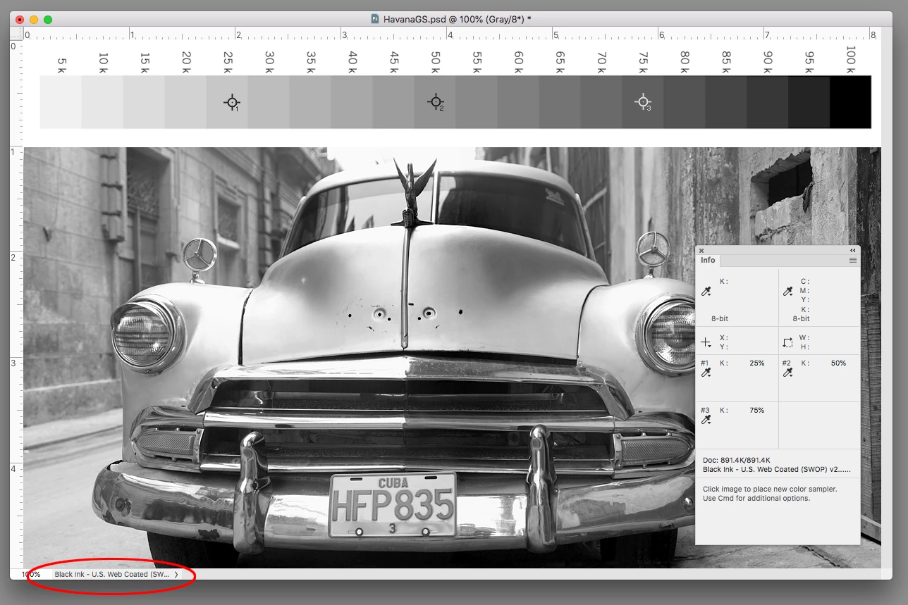

    For example, if your InDesign document has US Sheetfed Coated as its CMYK assignment you would want to use Black Ink -US Sheetfed Coated as the assigned Photoshop grayscale profile. Photoshop’s Info panel Actual Color shows the gray values that will output to the plates, and the Gray profile adjusts the soft proof to show the affect of dotgain:

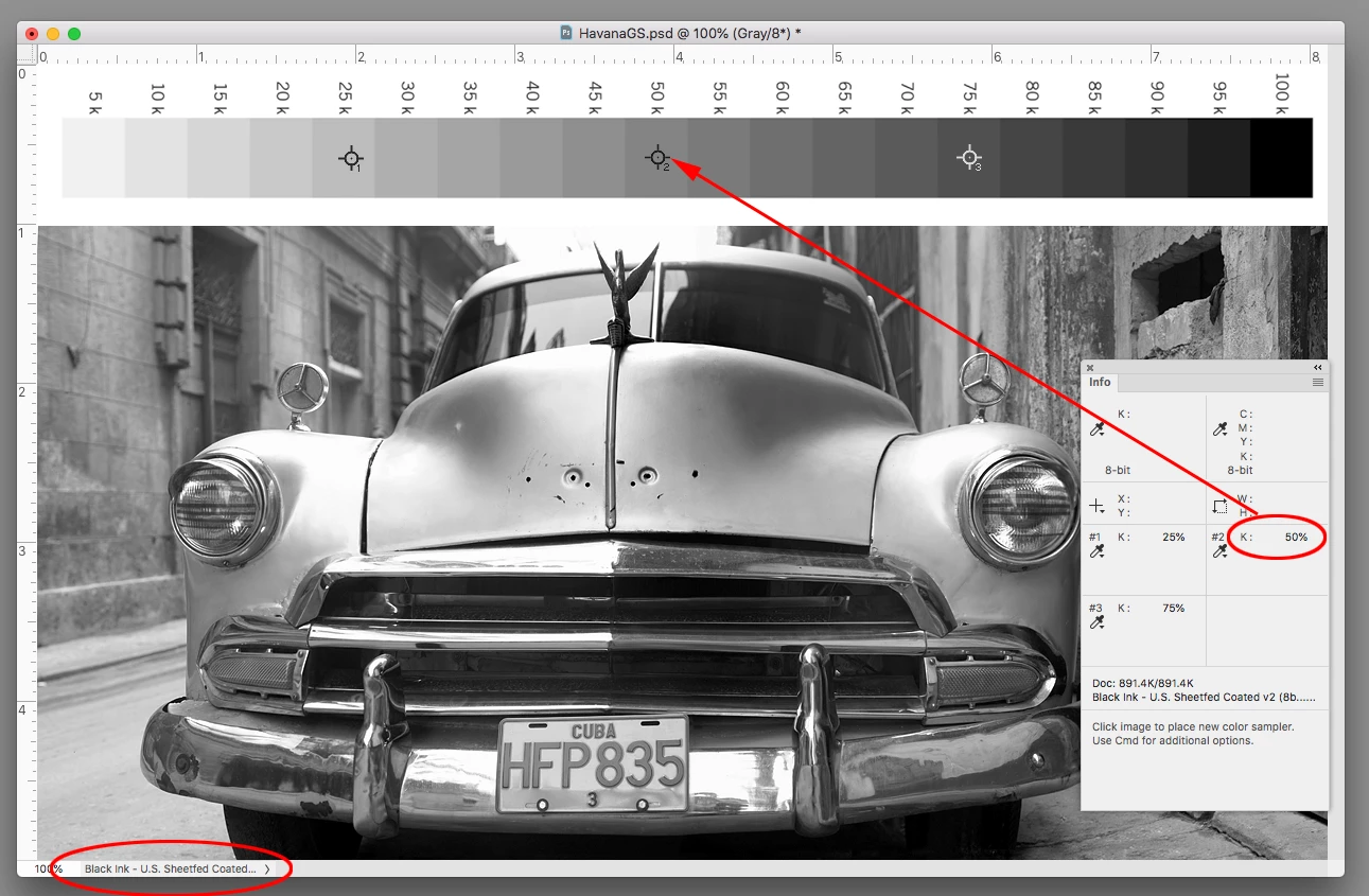

    Black Ink-US Web Coated assumes less dot gain, so the same output values display as lighter values:

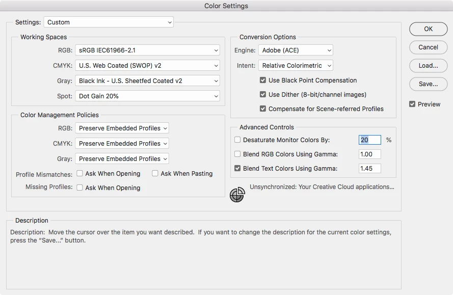

    To use a Black Ink profile in Photoshop open Color Settings>Gray Working Space>Load Gray... and choose the desired CMYK profile. The Gray profile will be listed as the CMYK profile with a Black Ink - prefix:

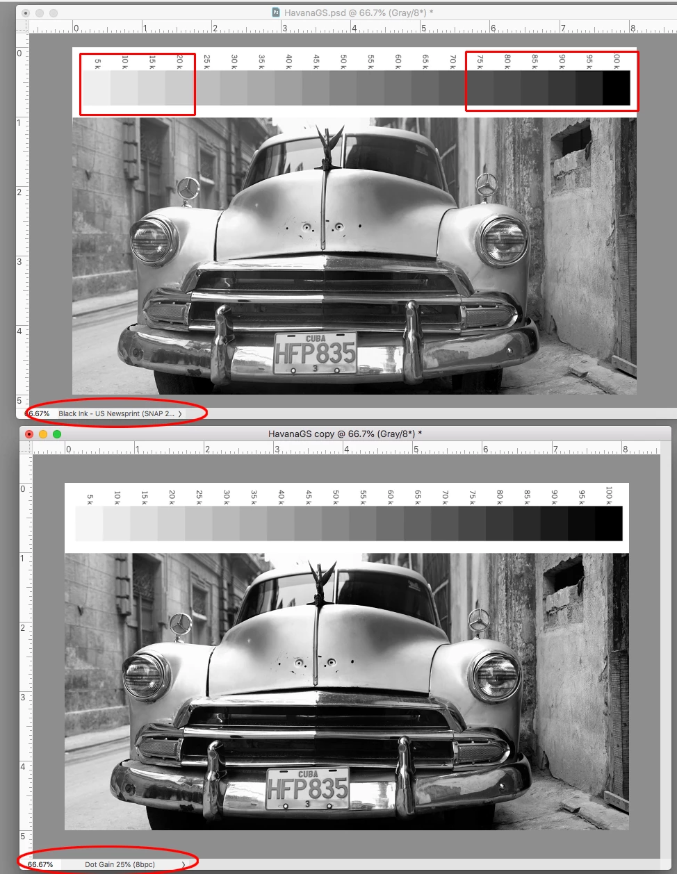

    If you use a profile that is designed for the destination press, you shouldn’t have to manually compensate because the assigned profile affects the preview. You can see that here where I’m comparing Black Ink-US Newsprint with Photoshop’s Dot Gain 25% curve.
    The DotGain 25% preview shows more contrast than will likely happen in the print—newsprint flattens contrast because of the absorbent paper, and the Black Ink US Newsprint profile is displaying the expected lower contrast.
