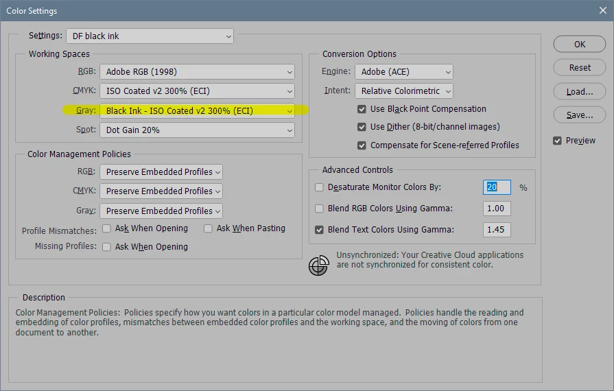

    In Photoshop you can convert grayscale images to Black Ink <CMYK profile>. Then you know it will be treated correctly.
    In Color Settings > Working Gray, click Load Gray and navigate to the CMYK profile you want, in this case FOGRA52. Once you've done this, it will also be available as a grayscale profile you can convert to.

    So, in Photoshop, I loaded the Black Ink from the required CMYK profile (Load Gray), I saved it as ICC (Save Gray) and I installed it. But it doesn't appear in Acrobat's Color Converter. Is there a way to load it there?
