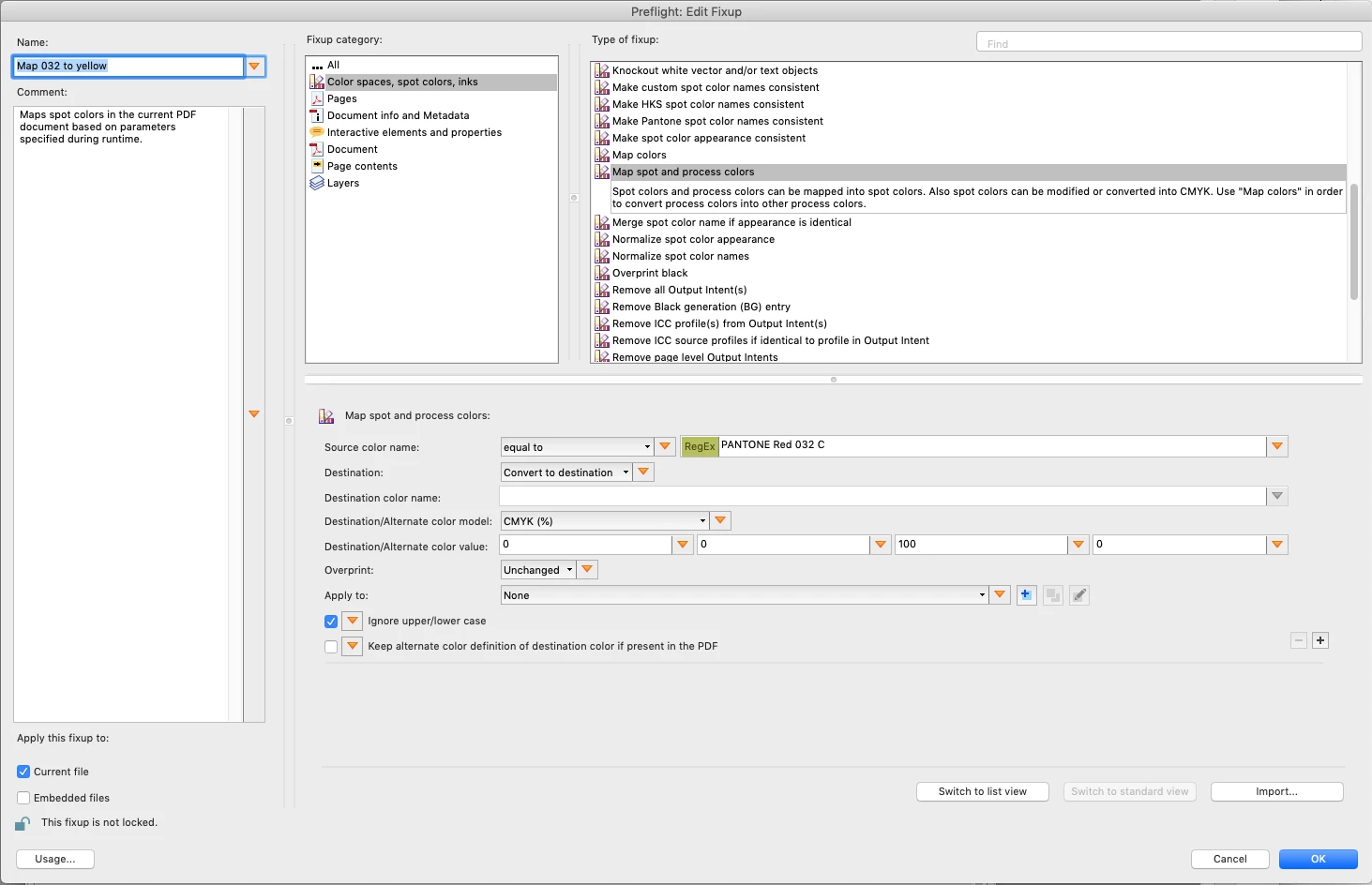

    You can use Acrobat to replace an existing spot color with a specific CMYK value. Go to Tools> Print Production> Preflight> Fixups (the blue wrench icon).
    Find the existing Fixup named "Map spot color with a specific name and color values" To edit this Fixup, you will first need to duplicate it, use the fly-out options menu at the upper right corner of the panel, give the Fixup a new name. The attached screen shot shows a custom Fixup that converts all instances of PANTONE Red 032 C to yellow (0,0,100,0).
