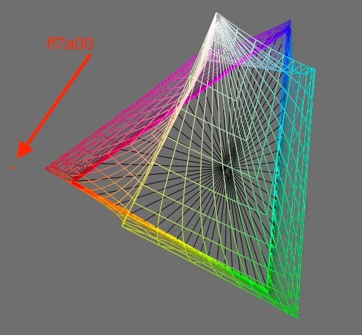

    About 2 years ago the team has elected Adobe RGB as our main color profile for creating graphics. We didn't do much of a researching job to get to this conclusion. People just filled two photoshop canvases with ou brand color (#ff7a00), one configured with sRGB color profile and the other with Adobe RGB and people felt that it "looked better" with the latter.
    Fun fact: I created a document in Photoshop using that color (ff7a00) and plotted its gamut 3D next to sRGB. This doesn't bode well for sRGB:
    And of course, your Apple Retina displays are wide gamut (P-3), closer to Adobe RGB (1998) color gamut than sRGB.
    What others outside your shop see, without such wide gamut displays, are again, nothing you can control.

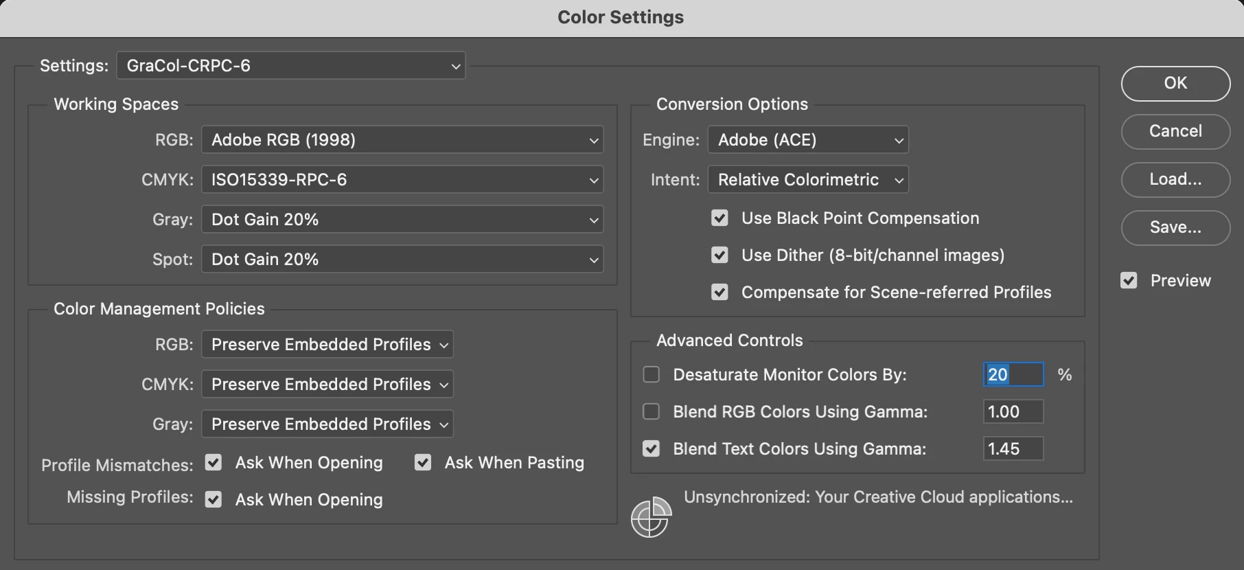

    Sep 1, 2022 1:48 PM UTC
    It depends on where your images are used, Arthur.  If they are only for presentations and web graphics, then sRGB is a good choice.  But if you include high-end print work like Sheetfed Offset printing, I recommend Adobe 98 RGB as the working space because sRGB is too small.   A good workflow if Sheetfed Offset is in your workflow is to set the standard color settings like the image below. When going to web files convert and export them with sRGB to keep the color accurate on the web.   Keep the files in Adobe RGB if going to an Offset print process, unless the printing company can not do it on the fly.  If the job goes on a digital press, the RGB portions will be converted to that press-specific color space.   Make sure that all image files include embedded profiles and color settings are consistent across all personnel in your organization.    We have multiple color management systems and presses where I work and they all support any embedded profile without issue.
