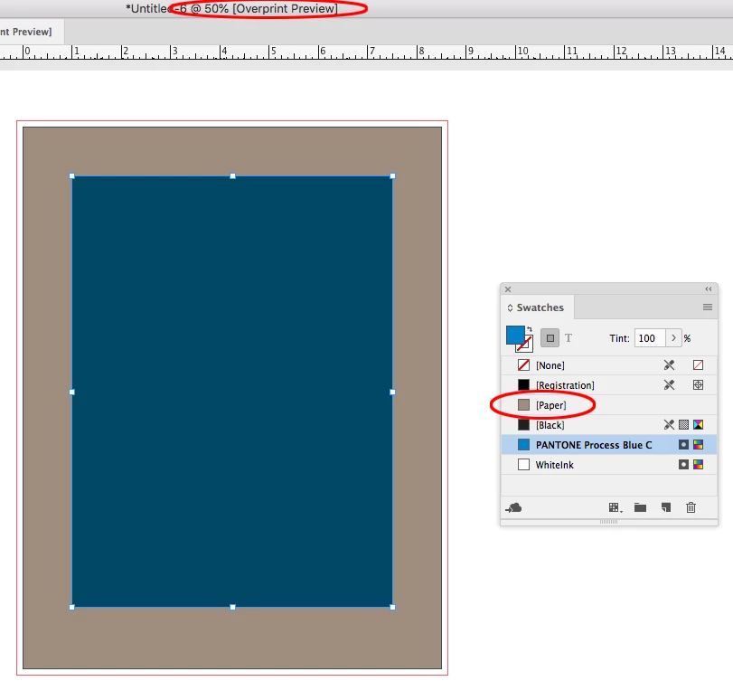

InDesign lets you simulate a paper color, but it would be a crude representation of a solid spot color overprinting a colored paper, and wouldn't necessarily be a reliable preview. Here's the default white [Paper] swatch (the [Paper] swatch does not output):
Here I’ve set it to a brown lab color and turned on Overprint Preview and InDesign attmpts to show me the affect of a transparent ink printing on the colored paper
