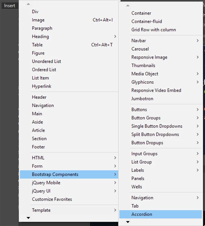

    OK.  If you're in the current version of DW, use the Bootstrap Accordion panels.
    Insert > Bootstrap Components > Accordion.  NOTE:  You need to be using a Bootstrap Layout to use Bootstrap Components.   See links below for details on Bootstrap.

    Which version of DW ?  It must be quite old.  Spry has not been around since 2013 when Adobe abandoned it.
    I don't recommend using Spry in current or future projects because the scripts have not been updated since 2006 (over 10 years).
    As a replacement, look at jQuery UI.
    https://jqueryui.com/accordion/#default
    The default mode opens 1st panel on page load.
