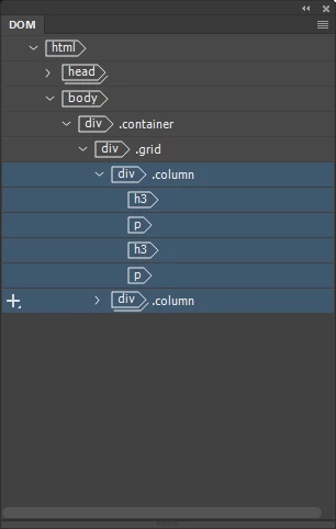

    Also, be sure your elements are correctly positioned as siblings, not parent/child elements, within your HTML. The DOM Panel won't let you select and wrap multiple elements that aren't on the same level (siblings), if you see something like this...

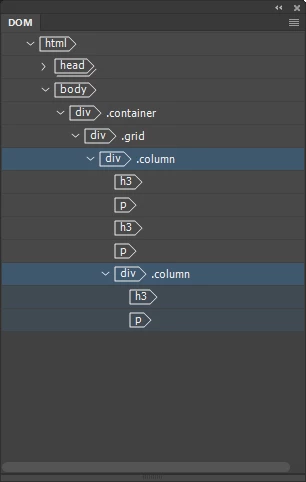

    You should have no issue selecting both DIV tags and getting the option to wrap them, but if you see something like...
    Where the second DIV is a child of the first, you won't be able to select and wrap both DIV tags. If your HTML were set up that way, you would only need to select the parent DIV to wrap everything in a new element.

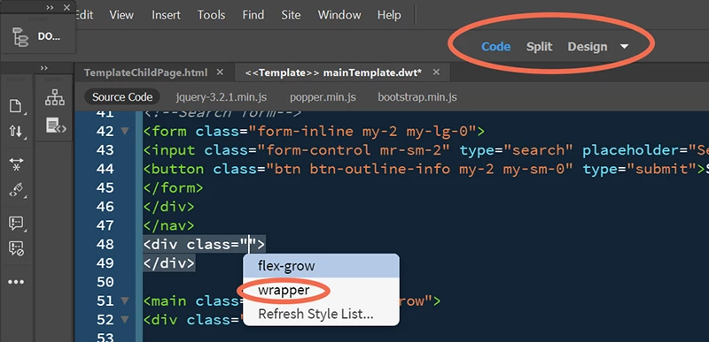

    But as longtime DW user, that's NOT how one would normally add classes to tags.  Working that way would add more tags to existing tags which leads to unwanted code bloat.  Or it wraps three tags inside yet another tag which is also not too beneficial in the real world.  To add an existing wrapper class to your element, see screenshots below.
    1. Open your template.dwt file.
    2. Switch to Code| Split | Design in your Document Toolbar.
    3. In code panel or DOM panel, select your target <div> tag.
    4. Assuming the CSS class is already defined in your stylesheet, the quickest way is with code hints and auto-code completion which pops up while you type.
    5. Another option is to add the wrapper class from your HTML Properties Panel (Ctrl + F3).
    Working directly with code is essential when you start working with multiple classes on single elements. Panels can't help you with that.
