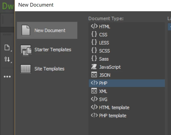

    Below are the file types that DW supports.  What kind of file type were you thinking of adding?
