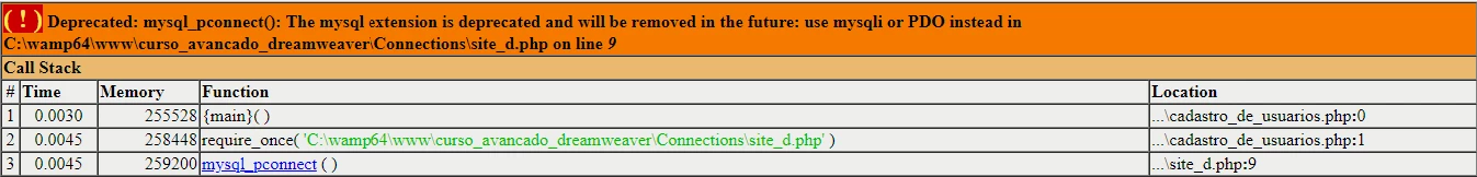

Yes.  Use the MySQLi (improved) extension to replace the current connection code.
It will look something like this.
<?php require_once('Connections/myConnect_i.php'); ?>
<?php require_once('webassist/mysqli/rsobj.php'); ?>

Does the site work even with this error?
BenPleysier
Apr 28, 2018 3:23 AM UTC
Ideally you should change your code. In the meantime you can try adding the following to the top of the page and fingers crossed that the site will still work.
<?php error_reporting( E_ALL ^ E_DEPRECATED ); ?>
