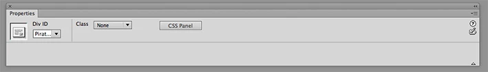

Working on my first website with Dreamweaver CS6 and wish to create an image map with hotspots. I'm in Design mode and yet when I highlight an image to draw a hotspot area with the polygon tool I'm confronted with an empty grey box.

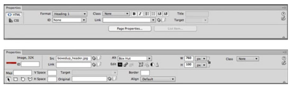

 Presumably the above with polygon and other tools bottom left is what I should see however all that I see is this >
 Any help would be greatly appreciated.
Kind regards, Garry.

    First, image maps are not natively responsive so it's really not recommended to use them.  There is a reference to options for this using javascript or svg images as a replacement that can be found here: https://stackoverflow.com/questions/7844399/responsive-image-map .
    To your specific images though, the second shows the image map option that you should see in your version of DW.  The first image shows the image map options that you should see. The second shows that you are pointed at a div and not at your image. This could be due to the code of your site and how your page is setup that is causing the div to be selected and not the image. If you are having trouble selecting the image no matter how you click, you may need to validate your code for errors ( https://validator.w3.org ).
