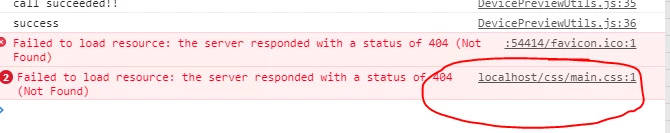

karpiyonAuthor
Dec 20, 2018 11:12 AM UTC
and this is the error in chrome when i user the "/" infront of teh css file
B i r n o u
Dec 20, 2018 11:22 AM UTC
did you manually change the HTTP port ?... from 80 to 55648...

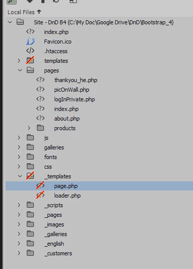

  • the path of the local site on your (physical) hard disk
    c:\My Doc\Google Drive\DnD\Bootstrap_4\
  • the screenshot of your test server settings made in DW
  • the screenshot of the DW file panels
  • the browser and URL address used to view the page
  • copy of the HTML code to manage links and includes....
    I am opening the file under /_templates/page.php so teh root is one directory above
    <link href="../css/main.css" rel="stylesheet" type="text/css">  this IS working
    <link href="/css/main.css" rel="stylesheet" type="text/css">  this is NOT working
THANKS

karpiyonAuthor
Dec 20, 2018 10:44 AM UTC
I have tried using / before the path but the file is not found.
When i try to  "view in browser" and then use the "inspect" option in chrome. i see that:
"http://localhost/main.css" cannot be found. i guess this is because the root of the server is "c:/xampp/htdocs" and not "c:/xampp/htdocs/DnD_B4"
On the actual website "/" in front will work but i need it to work on my local testing server as well without any script to find the root.
How do I configure aliases?
B i r n o u
Dec 20, 2018 10:52 AM UTC
well, to avoid any confusion and any untimely headache....
as a starting point, could you please tell me the following points:
thanks
