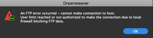

An FTP error occurred - cannot make connection to host. User limite reached or not authorized to make the connection due to local firewall blocking FTP data.
As from this afternoon I get this error when trying to connect to any FTP server for all the sites I manage with Dreamweaver. There was no problem this morning and I didn't change any settings anywhere. I wonder what happened and how I can connect again.
I am using Dreamweaver CC on iMac OSX Mavericks.

I just discovered a fix for this issue for the following error:
Basically in my case which may be similar to many others, was I uploaded the website to a host on cPanel to a folder that was >account>website_name>user>((website files)).
I needed to post these to the public_html folder, I did not specify this in manage sites.
So in my case, i moved my files in cPanel to the public_html folder but deleted the "website_name" and "user" folders on cPanel as they are now empty.
When i went to push files a second time that week to cPanel, i was getting the above error in screenshot.
I simply found out that dreamweaver was looking for the above path >account>website_name>user to post the ((website files)) to and it couldn't find it.
The fix is to re-create the folders that were deleted or missing and FTP them to those folders. Now ill move them again to public_html. To find out if you are missing folders in a path, check your FTP Accounts User Path and recreate any for dreamweaver to find and reconnect.
All works fine now with connections to FTP with Dreamweaver. It was just a file path issue in my case.
