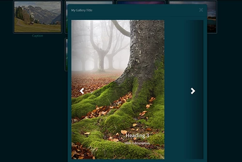

Do I recall correctly that the Bootstrap alternative requires all the images have the same shape?
Most lightbox/modal windows work best with images that have the same aspect ratio.   If you mix landscape with portrait, you're liable to end up with something like this:
