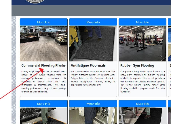

How is it possible to create a "card" with the Bootstrap framework that is entirely clickable. I am able to create a basic Card that has links attached to the images inside the card, or the buttons inside the card however I need to be able to have the entire area of the Card be clickable. I have tried wrapping the Card with various tags to apply Href links to but none of that seems to work. I do not see anything in the Bootstrap documentation stating how to do so. Thank you.

Thank you. That seems to works, I appreciate your help. What would be the method for creating a rollover effect on the entire card & it's contents: the button, image & cardbody. So if a user rolls over any part of the card all of the elements repond with a rollover. Below is the a simplified version of the HTML card code I am using.
<article>      //WRAPPER
<div class="card" data-link="LINK.HTML">     //CARD
<a href="LINK.HTML" class="btn btn-primary">More Info</a>     //BUTTON
<a href="LINK.HTML"><img src="IMAGE.JPG"></a>     //IMAGELINK
<div class="card-body">     //CARDBODY
<h5>TEXT</h5>     //HEADER
<p>TEXT </p>     //TEXT
</div>     //CARDBODY END
</div>     //CARD END
</article>     //WRAPPER END
Sep 24, 2020 8:00 PM UTC
