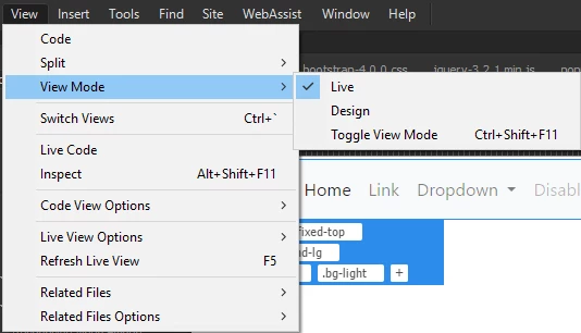

Make sure that you are in Live view and try again.
Apr 25, 2018 11:39 AM UTC
Yes, I have tried this with no success. I have tried a few things from forum posts with the same situation.

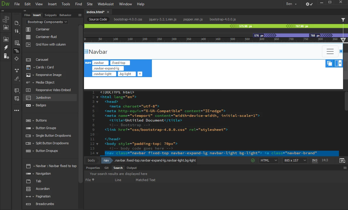

BenPleysier
Apr 25, 2018 12:10 PM UTC
I thought that I would try it myself and, as I thought, no problems.
