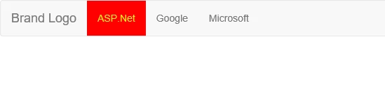

I/m not sure what exactly you are trying to do but if you want to change only one item then something like this in your custom style sheet or in your header style at the top of the pages would work:
.navbar-default .navbar-nav > .active > a, .navbar-default .navbar-nav > .active > a:focus, .navbar-default .navbar-nav > .active > a:hover {
    color: yellow;
    background-color: red;
You need to change the color in the above code.  I have deliberately used RED and YELLOW to make it clear to you and for anybody who wants to know this.
I have tested this using this simple HTML code:
<nav class="navbar navbar-default">
  <div class="container-fluid">
    <!-- Logo goes here -->
    <div class="navbar-header"> <a href="#" class="navbar-brand">Brand Logo</a> </div>
    <!-- Menu items -->
    <div>
      <ul class="nav navbar-nav">
        <li class="active"><a href="http://www.asp.net">ASP.Net</a></li>
        <li><a href="http://www.google.net">Google</a></li>
        <li><a href="http://www.microsoft.net">Microsoft</a></li>
      </ul>
    </div>
  </div>
</nav>
The output looks like this:
