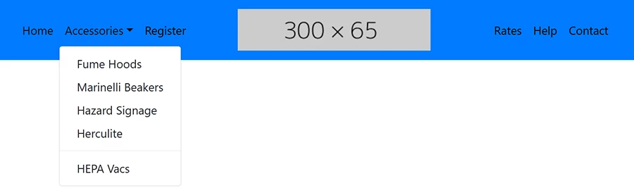

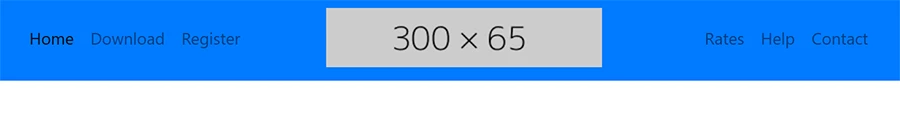

    Nancy OShea
    Jun 10, 2022 7:05 PM UTC
    HTML:
    <nav class="navbar navbar-expand-lg navbar-fixed-top navbar-light bg-primary">
    CSS ~ change opacity from .5 to 1
    .navbar-light .navbar-nav .nav-link {
    color: rgb(0, 0, 0, 1);
    Result:
    Jun 10, 2022 7:33 PM UTC
    Thanks very much, looks great.
