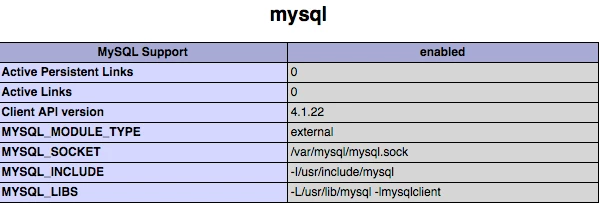

December 16, 2009
I tried using your code but it still didn't connect I thought I would check the version of php on my teacher's server (not the one that provides him the database, his server in his classroom)
and I used this code
<?php
// This is an example opendb.php
$link = mysql_connect('db****.perfora.net', 'dbo3**26***8 ', 'w**********');
